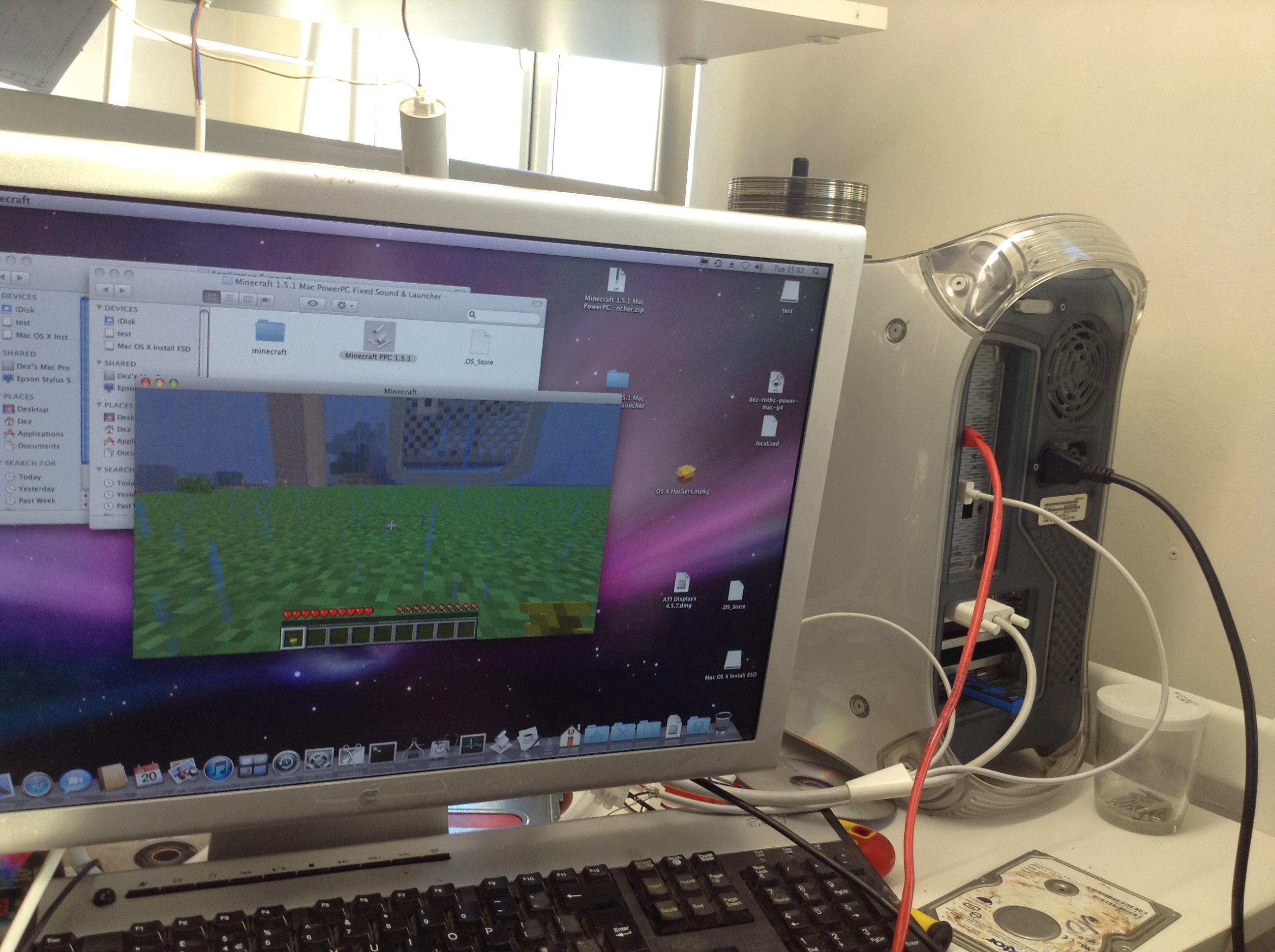

I have a really quite early Sawtooth (Uninorth 1 Rev 3) and it can boot from USB just fine
in-fact somewhere I have a photo of said Sawtooth booted into Leopard off a USB 3.0 stick plugged into a USB 2.0 card, playing minecraft LOL

to that! while doing a bit of digging I unearthed the photo I mentioned a few posts above 🙂 all the way back from 2015! one sawtooth Booted from a USB 2.0 card and USB Stick running Leopard playing Minecraft LOL
full
I was convinced but thanks for unearthing the photo - very cool! 😀
In the corner of your photo I spot a Maxtor HDD. They were my default choice for years in my PCs, Macs and external HDD enclosures. These days I buy HGSTs. 🙂
