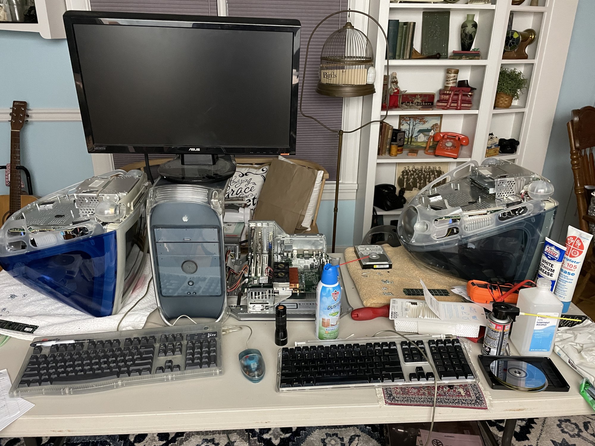

Short story: I have a an iMac G3 DV SE (Summer 2000) Graphite that I'm trying to get up and running. Its DVD drive seems to be dead, and its HD is functional but 100% blank. I can mount the HD using my modern MacBook Pro using adapters (ATA to USB2 and USB-A to USB-C). Can I install a PowerPC OS on the HD using my Intel MBP?
Long story: I want to install OS 10.4.11 and OS 9.2 on the hard drive so I can reinstall it in the iMac. But I can't figure out how, since the installers won't run on an Intel Mac. I have a USB external optical drive, but I can't boot the G3 from it. It seems to me that the best option is probably to find an ISO of a 30GB HD that already has 10.4.11 and 9.2 installed on it, and then figure out how to copy that over to the HD using Disk Utility on the MacBook Pro. Am I on the right track? Anyone know where I can find that?
I have these other assets, but despite opening them up and installing the Graphite HD into them they've all proven useless because I have no optical drive to read OS install media from:
iMac G3 350 (Summer 2000) Indigo with 9.2 installed. Works fine except the CD-ROM doesn't seem to work. No FireWire.
G4 Sawtooth, OS 10.2. Again, works fine except optical drive doesn't work.
Somewhere I have a FireWire cable that I could boot the G3 into target disk mode using the Sawtooth, but I don't see how that would help since the Sawtooth's optical drive is dead.
USB DVD-RW drive
Set of original 10.2 install CDs (although Disk 1 is stuck in the Indigo G3 and I can't figure out how to get it out, even after removing the drive from the iMac.
Holocaust cloak
Wheelbarrow
I'm not sure this matters, but my long-term plan is to get the iMac G3 DV SE working 100%, but in the Indigo case. The Graphite has been abused a bit (scratched, yellowed, busted speaker), while the Indigo is excellent condition and prettier IMO.
Maybe I need to just find replacement optical drives since that's the thing that keeps throwing up roadblocks.

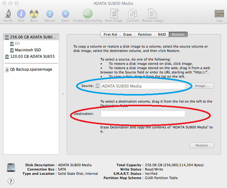

It's pretty trivial to restore older Mac OS X install discs to a USB drive with Disk Utility.
Blue: Install disc (The WHOLE device, NOT a partition!!!)
Red: USB Drive (again, WHOLE device, NOT a partition!!!)
Make sure the "Partition Map Scheme" is "Apple Partition Map" when done, otherwise it will not boot (MBR/GUID is for x86/Intel Macs).
This is Disk utility from 10.9 but it should be pretty much the same on newer versions. I'm just kinda lazy and can't be bothered to pull out my 2015 Macbook Pro.

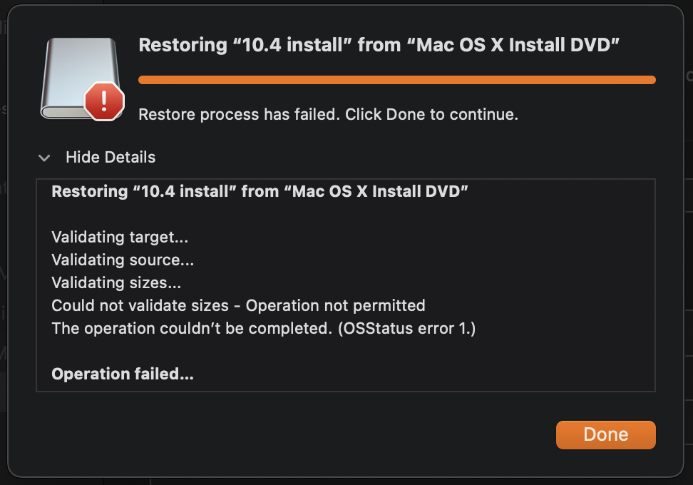

This was the first thing I tried. I downloaded an ISO for OS 10.4 installer, mounted it on my MBP, and copied its contents onto an 8GB USB drive, which was not recognized by the iMac G3 as a boot volume when restarting with CTRL held down. After this I did more research and read that iMac G3s can't boot from USB at all. So this raises two questions: (1) Can the iMac boot from USB or not, and (2) if so, did I prepare my USB drive incorrectly (maybe wrong format or something)?

1. Indigo 8GB HD (the one with OS 9 set up the way I wanted it) has now died. Won't spin at all. So copying OS9 from one iMac HD to the other iMac HD is no longer an option.

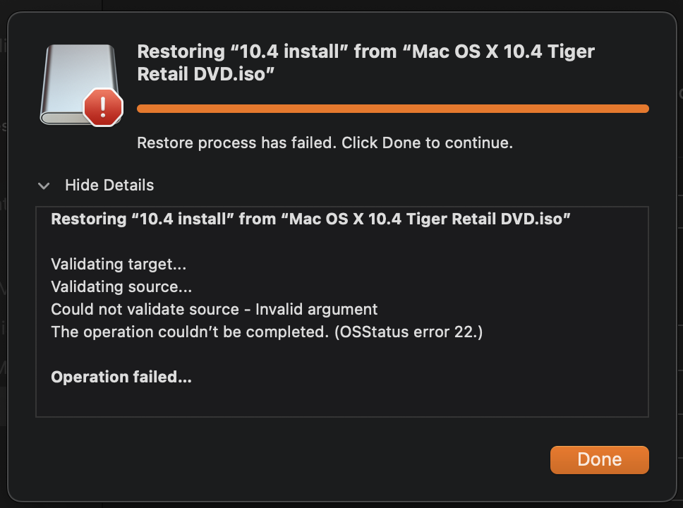

2. I downloaded 10.4 install ISOs from two different Internet Archive locations (Here and Here). I formatted an 8GB USB stick (SanDisk Cruzer) to Mac OS Extended (Journaled), Apple Partition Map. Attempted to restore from ISO 1. No dice:
The I tried it from the other downloaded ISO. Same result. Then I tried mounting the ISO and restoring from the "disk" instead of from the ISO image.

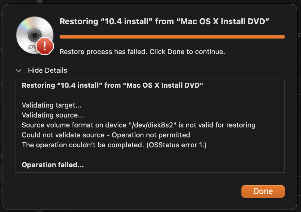

Finally, I burned the ISO to DVD-R, and attempted @TheShortTimer's suggestion (restoring from DVD media). Strike 3:

You used a modern version of Disk Utility and it doesn’t like the 10.4 image. No kidding. Try restoring the image to the USB drive using Carbon Copy Cloner or SuperDuper!.
