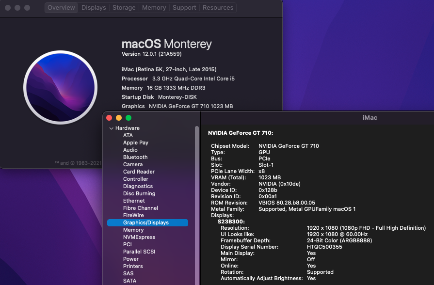

This is the Release install on Sandy Bridge system wit a Geforce 710 Kepler architecture
