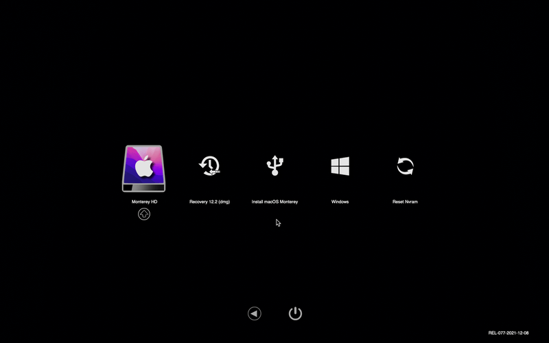

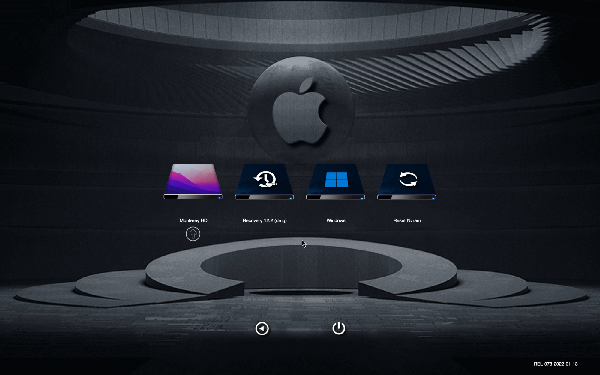

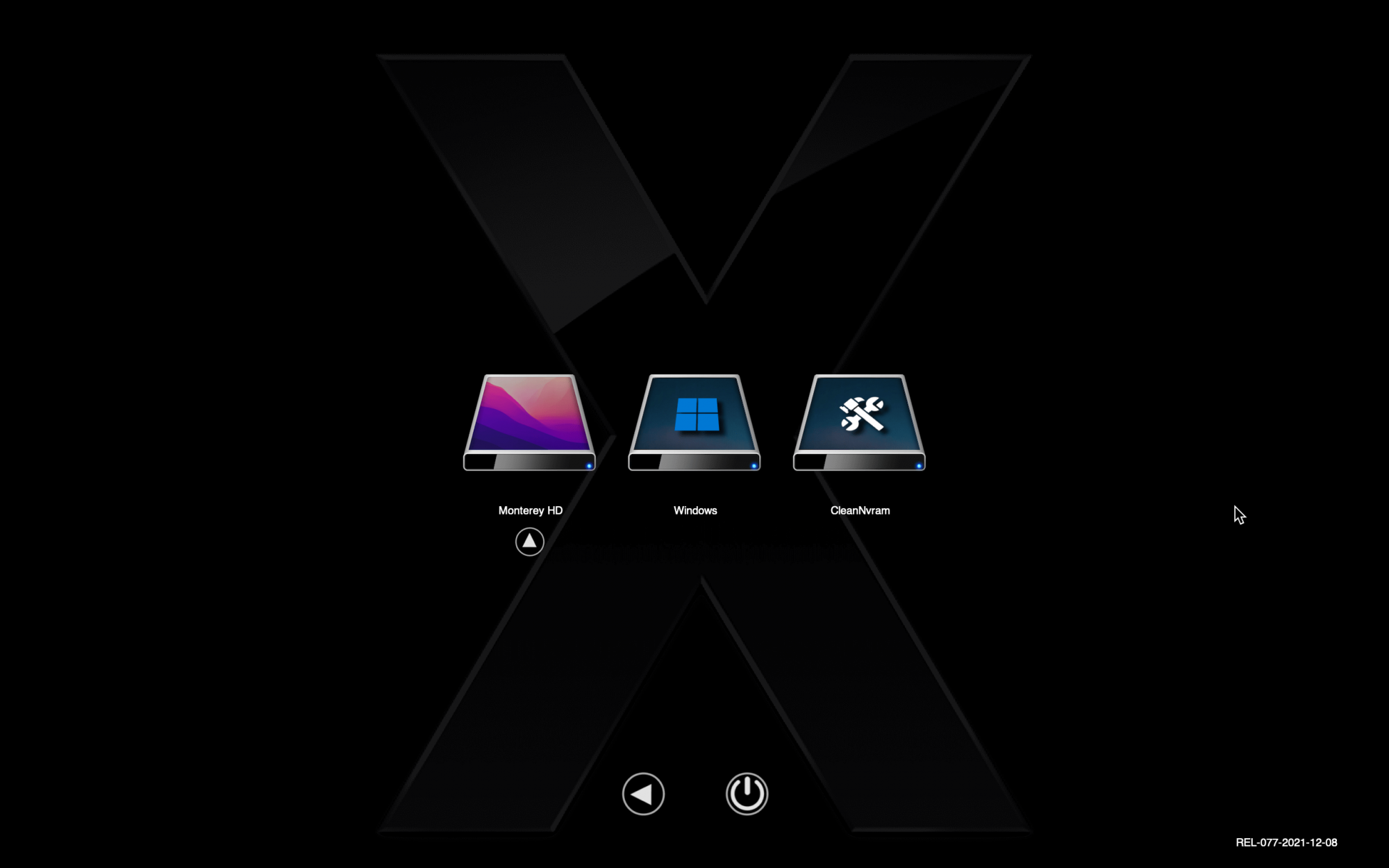

Change default theme for MinimalmacOS12, also enable Recovery HD on boot GUI
