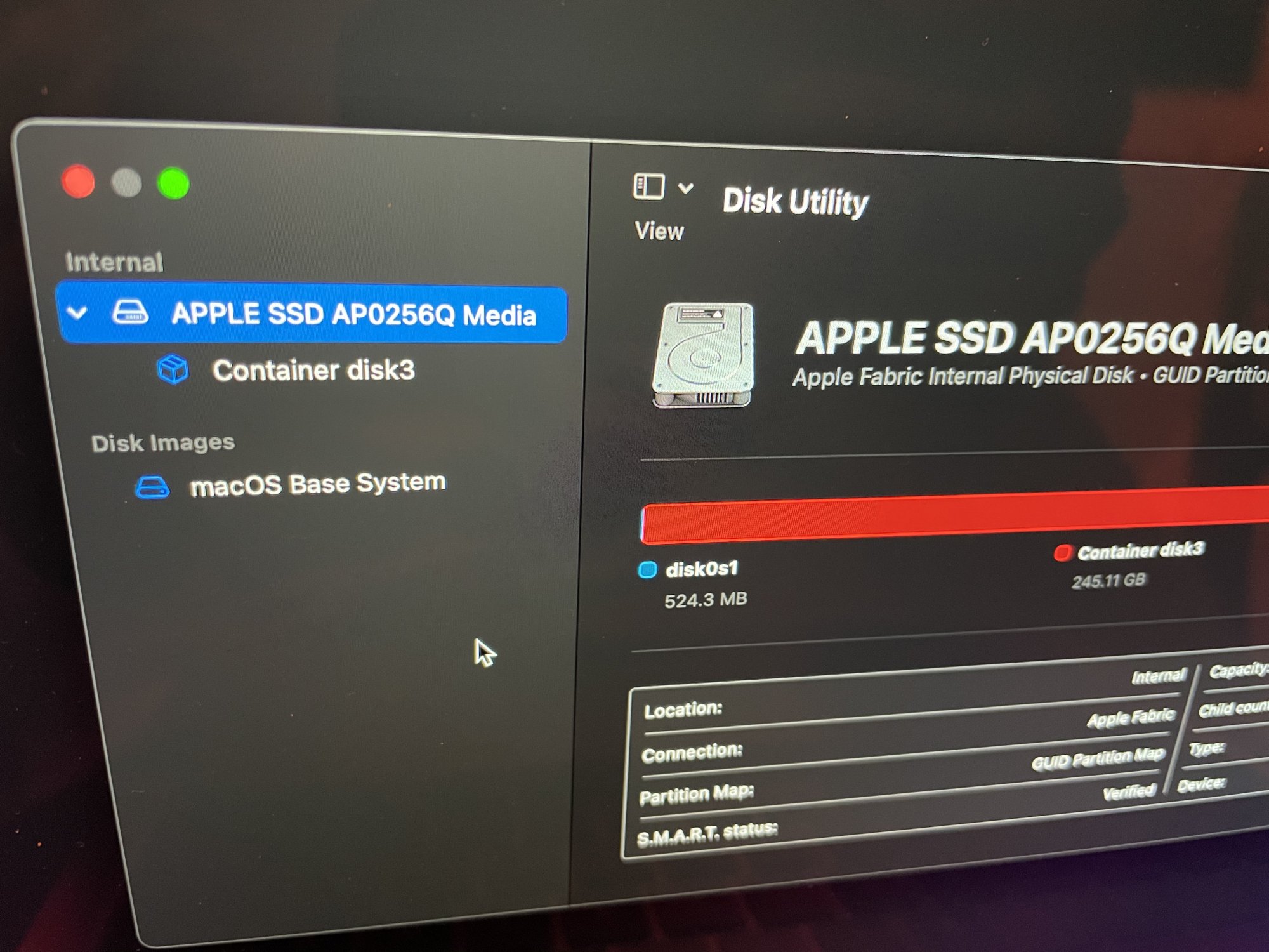

I tried these steps and I was able to erase the MacBook Pro 13” (2020)
But now have an even bigger issue; the Macintosh HD and Data has been replaced by an APPLE SSD AP0256Q MEDIA with a container disk3
And I am unable to re-install Big Sur or even add a volume or partition.
What do I do now?

I went to DU because when I got to step 8 where I re-install Big Sur it didn’t give me a disc to instal the OS on, so I checked DU, as that is the quickest way to check why I didn’t see Macintosh HD
every step described worked perfectly.
I was very happy when I got to the Activation part, because that’s where I kept having to log in with my AppleID, eventhough I removed it from the iCloud.
Sorry if I wasn’t clear, it’s been a frustrating evening.

Your drive doesn't look how I'd expect it to look. It may be enough to delete the container and reformat in APFS but that's a grey area on these M1's and I wouldn't recommend that unless all else fails.
I know you've followed the guide listed above but Apple's guide is slightly different in that a couple of the steps need repeating.
I'd follow the guide below exactly (including the two repeated steps) and see if things improve regarding re-installation.
https://support.apple.com/en-us/HT211983
Go from the second option (after the Apple Configurator 2 steps) which is similar, but not the same, as what you've done.
Good luck and let us know how you go on.

Thanks so much!
edit:
It sure seems this fixed the issue of getting the Macintosh HD back. It showed up as “untitled” so I changed the name.
Installing Big Sur now again and hopefully this whole adventure solved everything and it’s as good as new again.
the issue seems to be resolved because on the Apple support page it stated tot repeat steps 3-9.
thanks again.
