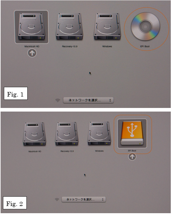

  • Start Boot Camp Assistant
    When you start Boot Camp Assistant, three check box, (all of them checked) appear. As title says “Select Tasks”, all those three are options. (You must select at least one to continue)
    - Create a Windows 8 or later install disk
    If you install from DVD or you already have installer USB, uncheck this box and connect optical disk drive and insert Windows installer DVD or installer USB. Otherwise, Boot Camp Assistant will not let you proceed.
    If you want to create USB installer disk, leave it checked.
    - Download the latest windows support software from Apple
    If you already have downloaded Boot Camp drivers, you can uncheck this box. However, please insert USB which contains Boot Camp drivers. Otherwise Boot Camp Assistance will not let you proceed after step 2.​
    - Install Windows 8 or later version
    This is the main task to perform. Please levee this box Checked.​
    press “Continue”.
  • Select partition size for Windows
    The window shown in Fig. 2 appears. You can drag the border between OS X and Windows to adjust the size of Windows partition. (20GB or “Divide Equally” are not only choices)
    When done, press “Continue”.​

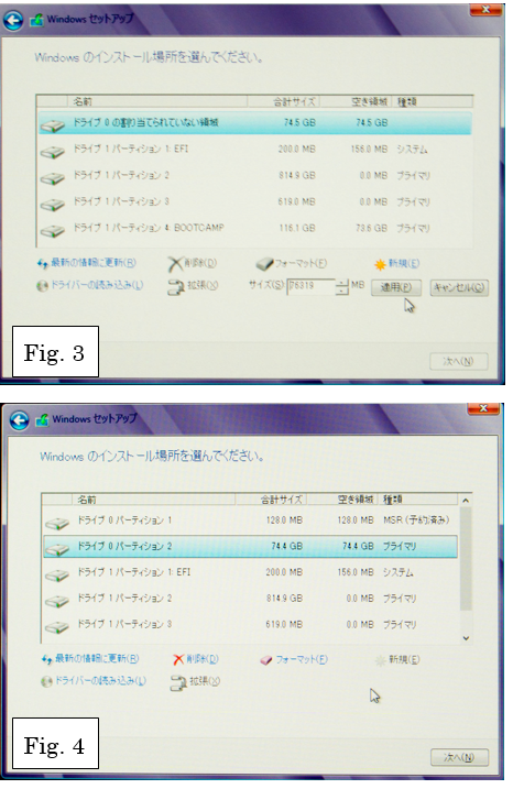

  • Follow instructions of Windows installer
    Select Language, Keyboard etc. Just follow the installer guidance, until selecting partition to install Windows.​
  • Select Partition to install Windows
    When the installer asks to select the partition to install, you have to carefully pick the correct partition. Select the last partition named “Boot Camp” and double check the size of the partition is what you chose at step 3. (the size may slightly different, because OS X and Windows calculate differently)
    Then the installer says “can’t install Widows on partition 4”. This is because the partition is not NTFS. Select “Format(F)” located under partition list box.
    Then press "Next"

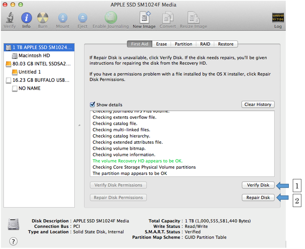

Verify and Repair the partition map error on your SSD
For me, at last, NVRAM reset removed the all error, so I forgot to tell one more error recovery I'd done, before NVRAM reset.
That is verifying internal SSD's partition map.
When I run the Disk Utility, I realized nMP internal SSD had some error, and fixed it.
[Procedure]
  1. Run Disk Utility.
  2. Pick " xxxB APPLE SSD" on Disk/Partition map on the left.
  3. Press "Verify Disk" button at lower right. [ arrow 1 ]
  4. If you see no error like fist thumbnail, OK. Close Disk Utility. Finished

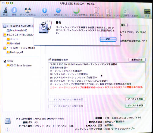

  5. If you see some error, like second thumbnail, try "Repair Disk" [ arrow 2 ]
    Sorry for the moire and language is Japanese, but key point is, if there's error, it will be highlighted in red and warning message appears on top. The error message says that Partition map need to be repaired. There is a problem on the file system of EFI system part ion.
Disk Utility running under OS X may not fix the error, while OS X is running, or disk is locked by Boot Camp. I actually fixed my SSD's error from Disk Utility under Recovery Disk.
Recovery Disk does not go into recovery automatically, so it is safe to run.

  • Reboot your system
    Make Sure Boot Camp Driver USB and Windows installer USB/DVD are connected to the system.
    When boot starts, hold down option key until boot selection appears. (Fig 1 or Fig 2)
    Select EFI under USB or Opt Disk icon.
    Windows installer boots and starts installing process.​
    When the installer asks to select the partition to install, you have to carefully pick the correct drive.
    If the partition name you assigned at step 1 appears, that is the correct partition and disk. Please double check the size of the partition. (the size may slightly different, because OS X and Windows calculate differently)
    I tried Thunderbolt connected SSD, then the drive appears as disk 0. However, I don’t understand how windows installer numbers different drives, don’t assume that disk 0 is the external drive. If you connect external disk through USB, it may appears as disk 1.
    Once you identify target partition you created, select that and press “Delete” button under partition list box. There’s small partition for EFI on the same disk. Also delete that EFI partition and make the disk space all “Un-Allocated”. Then select “New” and specify the partition size you want to create. If you allocate all disk space for windows partition, then just press “Apply”. Windows installer create 2 partitions. The second partition is install partition and already selected. Press “Next”

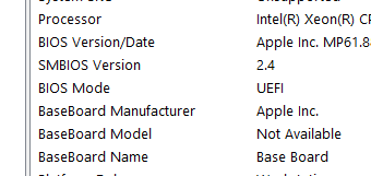

I installed Windows 8.1 using an EFI install (thus avoiding Boot Camp) more than a week ago and have posted about it numerous times in this thread. Even so, some folks have still had no success getting an EFI install to work on their nMPs, even when completely avoiding Boot Camp, so I wouldn't assume it's a cure-all for the problems many are facing. ytoyoda had luck installing Boot Camp on his nMP on the first attempt, so it's a stretch to assume that what works on his computer will work for everyone.
The article you cited did not use GPT disk, so technically it's not an EFI Boot install of Windows and I don't believe your Windows icon based on this article as shown in the boot menu is called EFI Boot. Please correct me if I am wrong here. Other than that I agree with you completely and that's why I never stated or even implied anything that EFI Boot is a cure for all others' problems in my post.
Actually ytoyoda made it very clear in his post to which I referred that you have to first fix the internal SSD issues before using either Boot Camp or EFI Boot instal successfullyl. Whether people agree with his points is really not my business. My post was merely focused on how his detailed EFI Boot procedures could also be applied to older MPs and that's it. If my post somehow mislead you in any other way, then it's my poor communication skill to blame.
You're probably right. I did run into an error when cloning my original Windows installation to a new external SSD that forced me to run the following command:
bcdboot C:\windows /s Z: /f UEFI
which I assumed copied the UEFI files from my Windows partition to the boot partition on my external SSD. Also, Windows says I'm running in EFI mode (see the BIOS Mode line in the screenshot below). However, Disk Utility on the OS X side says that both partitions on my external SSD are MBR and not GPT so I'm not sure what's going on (aside from that fact that it seems to be working fine).
My point wasn't to poke you or ytoyoda in the eye; it was simply to temper hopes that he'd stumbled across the end-all, be-all fix...although someone else has now reported success with the NVRAM reset!
