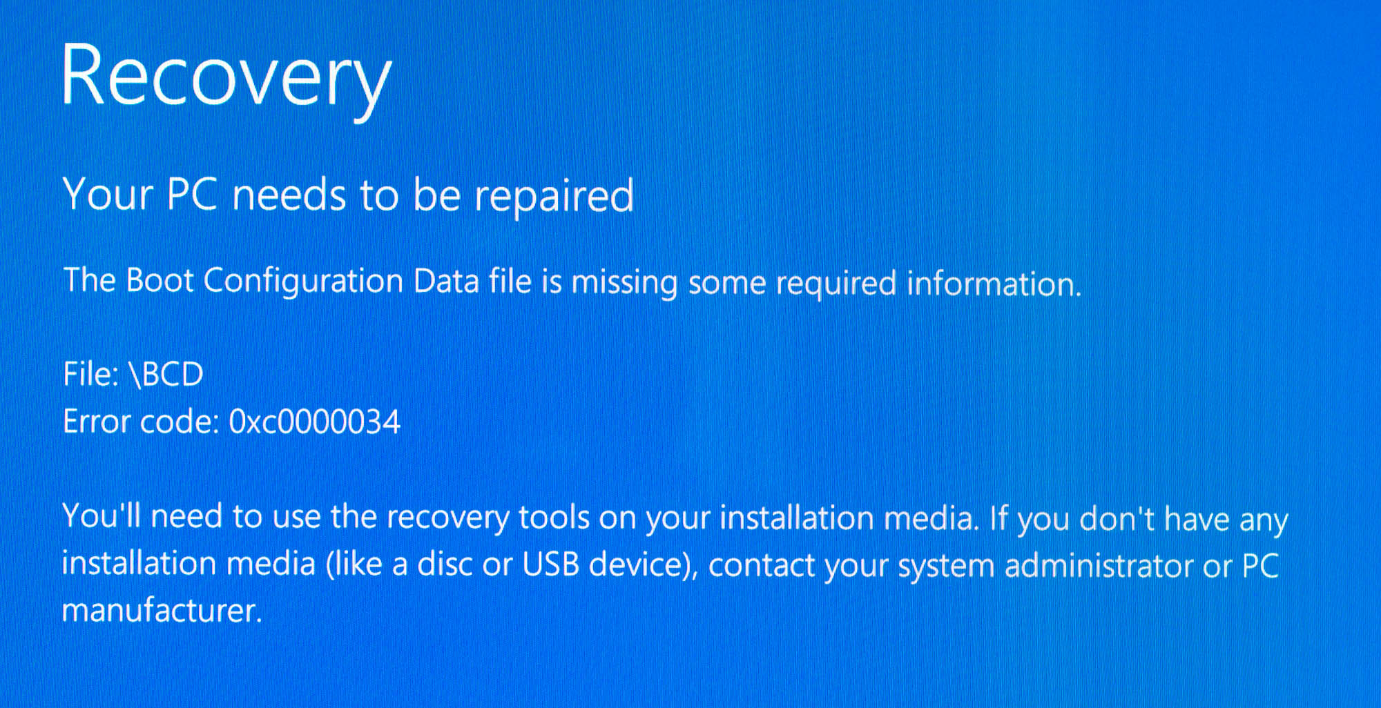

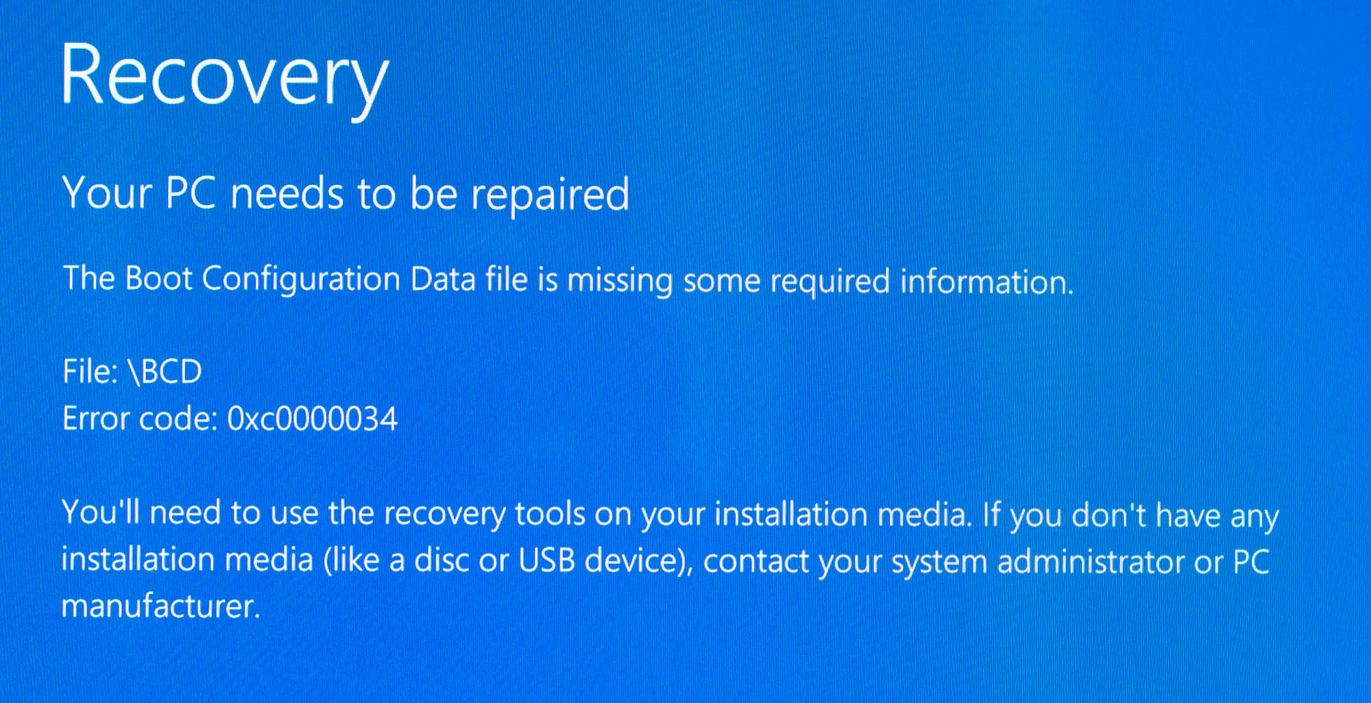

I tried this first thing this morning. However, Windows installer does not allow me to install on the disk through USB.
I also tries to boot from the SSD, which was installed on Thunderbolt connection.
On Mac Pro's boot screen, the SSD is recognised, and Mac Pro tries to boot from it. However, boot fails, probably because the incompatibility on EFI information.
I attached the screen. This is exactly same screen when I tried to boot the installed disk by other Mac. (I tried both MBA and iMac).
So, detail answer is, new Mac Pro can boot from USB3 but Windows installer does not allow to install on the disk through USB.

I think, the error encounter on EFI install and Boot Camp install is same.
After my first success, I removed the Bootcamp Partition by Boot Camp Assistance, then I encountered "can't update boot configuration" error at the first step of windows installer.
And the important thing is, during this period, I also encountered the same error on EFI install trials, I repeated many times.
Then, I did two things.
1. I found partition map error on internal SSD. Fixed it by Disk Utility in Recovery Disk. (But issue has not solved.)
2. Reset NVRAM
Then everything turns to workable. Now Boot Camp install works, EFI install works.
So, I conclude that when Boot Camp Assistant remove the Boot Camp Drive some error was introduced. It prevents Windows installer to change boot configuration, which is necessary for the following steps of the installation.
This error, at least my case, was recovered by these two steps.
So I would like to encourage people try these simple two steps, if still have Windows installation issue.
