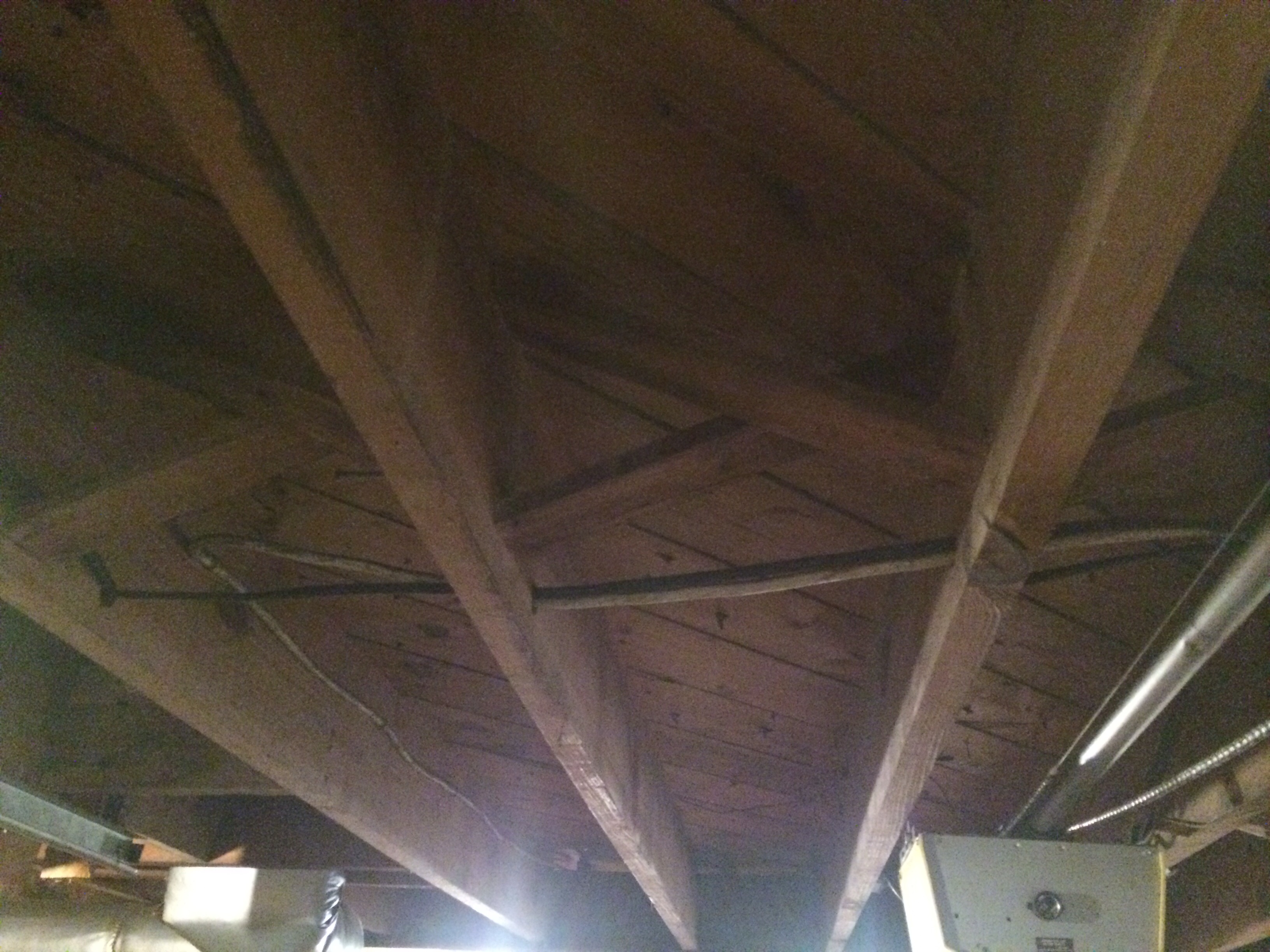

Here is a picture of the garage ceiling. Directly above this is my living room and it has hardwood floors. The house was constructed in the 50s. I assume there isn't insulation between the pieces of wood in the picture and my hardwood, correct?

Well I can see why your floors are cold! There might be a vapor barrier between the two floors, but considering the age of the house even that is doubtful. I would recommend installing insulation batts between the joists then a vapor barrier and finally sheetrock the ceiling. It will cost some money, but it is something that needs to be done.
That picture shows a garage that is illegal by todays code (at least in my area). An attached garage like you show should be fully isolated from any living space and not allow any vapors into any other room.
To do it properly you will need to put insulation in, then drywall the area, then go around with a caulking to seal all the joints where drywall meets drywall and where the drywall meets the floor/cinder block walls.
Franky I am surprised an inspector did not catch that when doing the review. Unless it is not code in your area. Had my garage looks like that my inspector would have advised me to not buy the house until that was fixed or that there be something in the contract in the way of money compensation to make sure the work would be done upon me moving in.

Unless I'm mistaken, just because it doesn't pass code now doesn't mean it didn't when the house was built and does not mean it should "fail" the inspection. Sure, the inspector probably should have noted it on the inspection but it might have been tough to make adding the insulation a condition of the sale. The building should be grandfathered regardless of change of ownership. Now if any structural, electrical or plumbing changes need to be made (and inspected) in the space, it ma need to be brought to code.
As for the original question, yeah that would certainly cause a cold floor and I would make efforts to insulate the ceiling/floor. I would do fiberglass batts and, if you have the headroom, foam sheets. The bracing looks like it might cause some cold spots, the foam sheets could help even things out.

You are correct on the being grandfathered in thing. It still should have been pointed out by the inspector. I would cringe if there as any plumbing running through that area, count yourself lucky if you are in a cold area and no pipes have burst.
Batt insulation is likely going to be your best option. If you really want to spend some money and "do it right" you could find a local company that does spray foam insulation. Have them come in, spray foam, and then put up your drywall.

Spray foam has a couple of advantages over fiberglass batts.
Due to its nature it is very effective at plugging up any air gaps. Cold air infiltration really diminishes the effective R-Value of insulation. And, again, the OP really needs to find a way to prevent the toxic vapors present in a household garage from getting into his living space.
The other advantage of spray foam (in this instance) is that it is very good at fitting around existing conduits, bracing, etc. You can cut and fit fiberglass batting, but compressing it (as you almost inevitably have to do) decreases its effective R-Value.
Its not cheap to have a professional company come in and spray insulating foam. However the energy savings, combined with the reduction of hazardous vapors, and increased household comfort - really ought to make this a "no-brainer" sort of investment.

West Virginia is certainly not a tropical climate. I'd be willing to be that any new construction would require that garage ceiling to be insulated, and that this requirement has probably been in place there for decades. If you mentioned the year the house was built, I missed it.
"Roll out" or insulation batts between joists will help reduce the transfer of cold through the flooring. However, the joists themselves will transfer cold to the floor also. Therefore, rigid insulation under the joists would be needed to reduce that. But, you've got a garage door opener to work around, probably some lights and conduit, or anything that's secured to the joists. Try the batts between joists first and see if that helps enough, or if more is needed.
Rigid insulation can be easily damaged, so if that is added, you might want to cover it with 1/4" plywood or some drywall. How thick you go will depend on how much head room you have in your garage.
Many modern houses have 1" rigid insulation as sheathing on exterior walls, with vinyl siding over it on the outside, and of course, drywall on the inside. Plus, a blown in insulation is often installed from the inside, after a vapor barrier is stretched over the wall studs, and, obviously, before the drywall is hung. That's the same method that you may want to apply to your garage ceiling, using insulation batts instead of loose insulation.
Fire-rated drywall for the ceiling would be best and is probably code. Something you'd want to consider especially with living space directly above. We had a client whose house burnt down, it started in the garage from faulty wiring in their SUV, --happened just as the owner was going to bed, fortunately not after! Their house was huge and only one story but it raced from one end to the other rather quickly.
Because of the cross-bracing, spray foam it!
We did six inches of spray foam in a basement ceiling (almost exactly like yours) to insulate for a walk in cooler. Worked like a charm!
It can be done right around the existing wiring and utilities, creates an air-tight seal, and will be done a lot faster then messing with batting. Yah, it's going to be more expensive, but you will end up with a better seal, more insulation, and much less disruption to the family and living space (much faster). One suggestion - if you are planning on any utility or wiring upgrades, get them done before you spray foam!

Agreed, do any wiring or plumbing work before spraying. That stuff will harden up and make it nearly impossible to snake wires after.

What R value would you recommend? It gets around 45 or so in that garage.

West Virginia is listed as "Zone 4" in the US by the EPA for purposes of insulation recommendations. Flooring in Zone 4 should be a minimum of "R-25 to R-30" - and the Johns Manville fiberglass you linked to has an R-Value of 13
Its up to you to decide if you want to put in the less than the minimum recommended insulation. But I'd keep in mind that insulation with more than twice as much thermal transfer resistance only costs a few dollars more per roll. Given that most of the cost of your upgrade is going to be for labor and/or time - I'd give serious consideration to using batts with an R-30 rating.
The extra $50 or so that its going to cost to insulate your garage (with high R-value materials) will be repaid pretty quickly through reduced heating and air conditioning bills.
