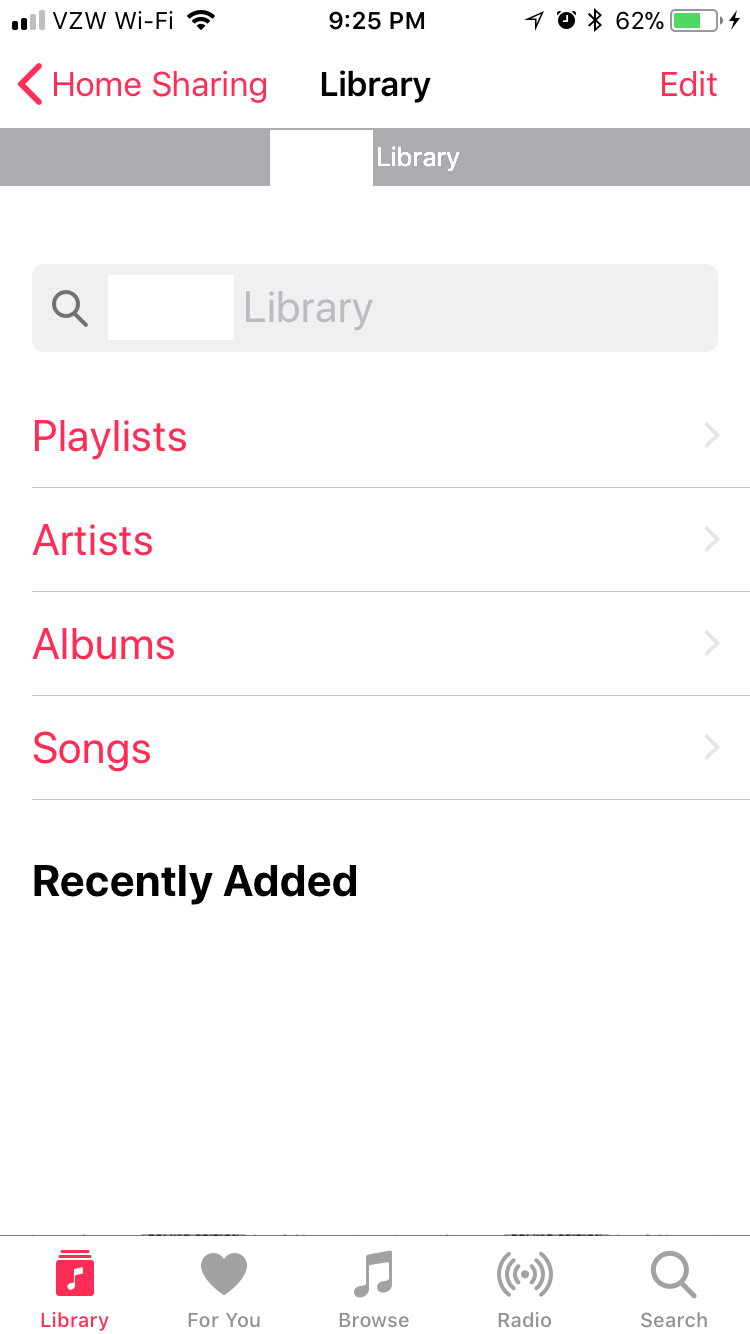

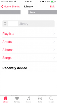

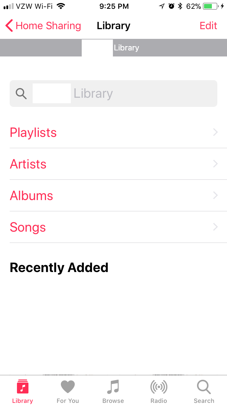

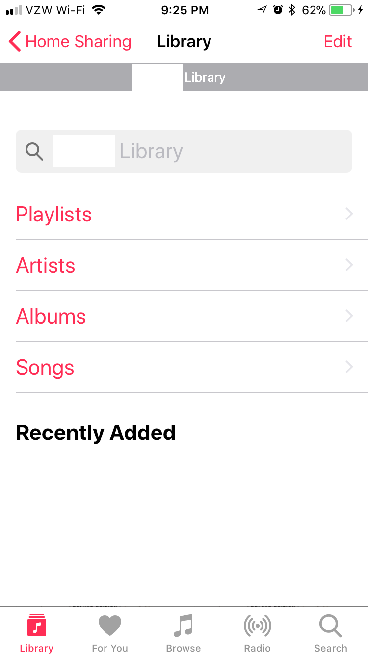

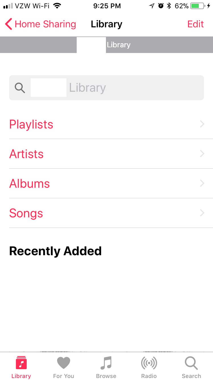

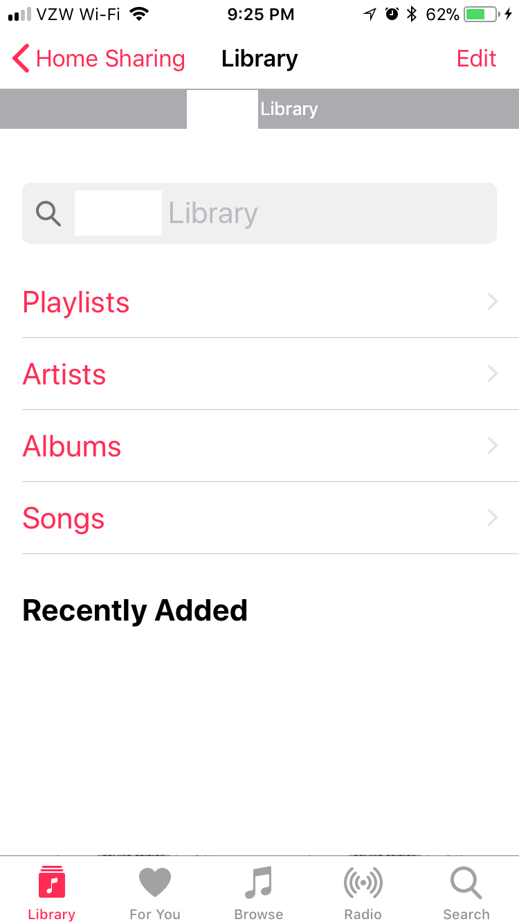

Home sharing has been iffy for me on iOS 11 and iTunes 12.7. It works the majority of the time but I’ve had occasions where it just died for hours to come back
This is good to hear, although the problem is with the Videos app (not the TV app). Can you check whether you can playback some videos using Home Sharing or not?
Sorry about that, that was for Music.app. I have the TV app (US) not videos though. With the TV app I can home share my videos from my iMac (MacOS 10.13.1 and iTunes 12.7.1.14) to my iOS devices (iOS 11.1.1) without a problem.
Something to note though. Initially with the TV.app AND Videos.app (before we had the TV.app) the only way I could make Home Sharing work on iOS devices was to have 1 movie (any movie) downloaded onto the device. If I didn't do that Home Sharing would not even pop up as an option. That "solution" seemed to fix the same problem for a lot of people on here.
Reactions: GuilleA
