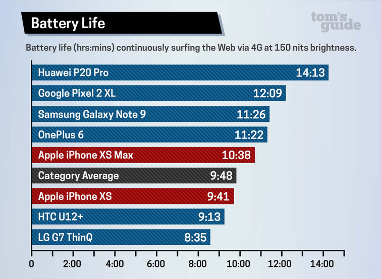

A phone with a larger capacity battery will last longer between charges. Ergo, fewer charging cycles per year. My Lenovo P2 with its 5000mAh battery typically lasted two days between charges. A phone with a small capacity battery that needs a charge each evening to last the day will experience a much higher number of charging cycles per year.
A fair point, but the capacity differences between common devices aren’t really of that magnitude.
For example, the Note 9 lasts 19% longer than the Xs in these conditions, which probably won’t translate to a significantly fewer number of charge cycles over a, say, three year lifespan.
