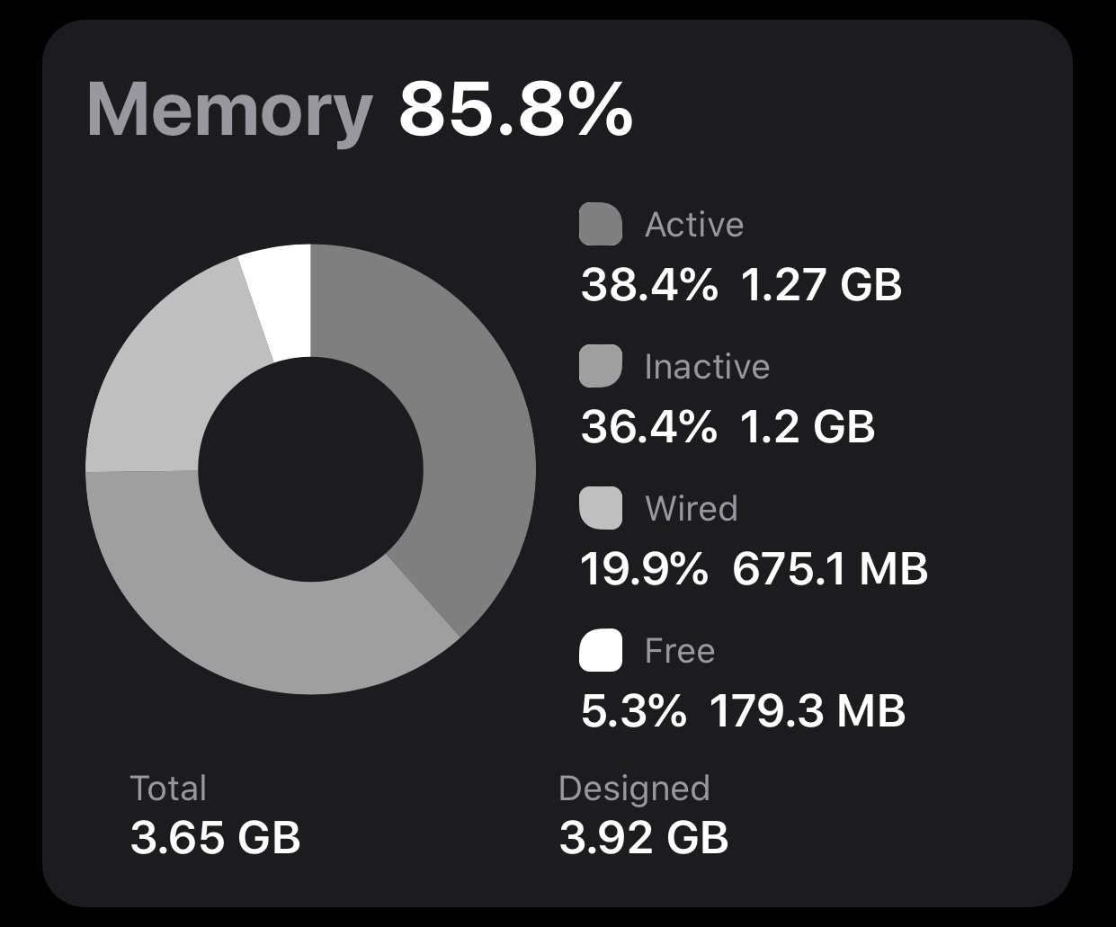

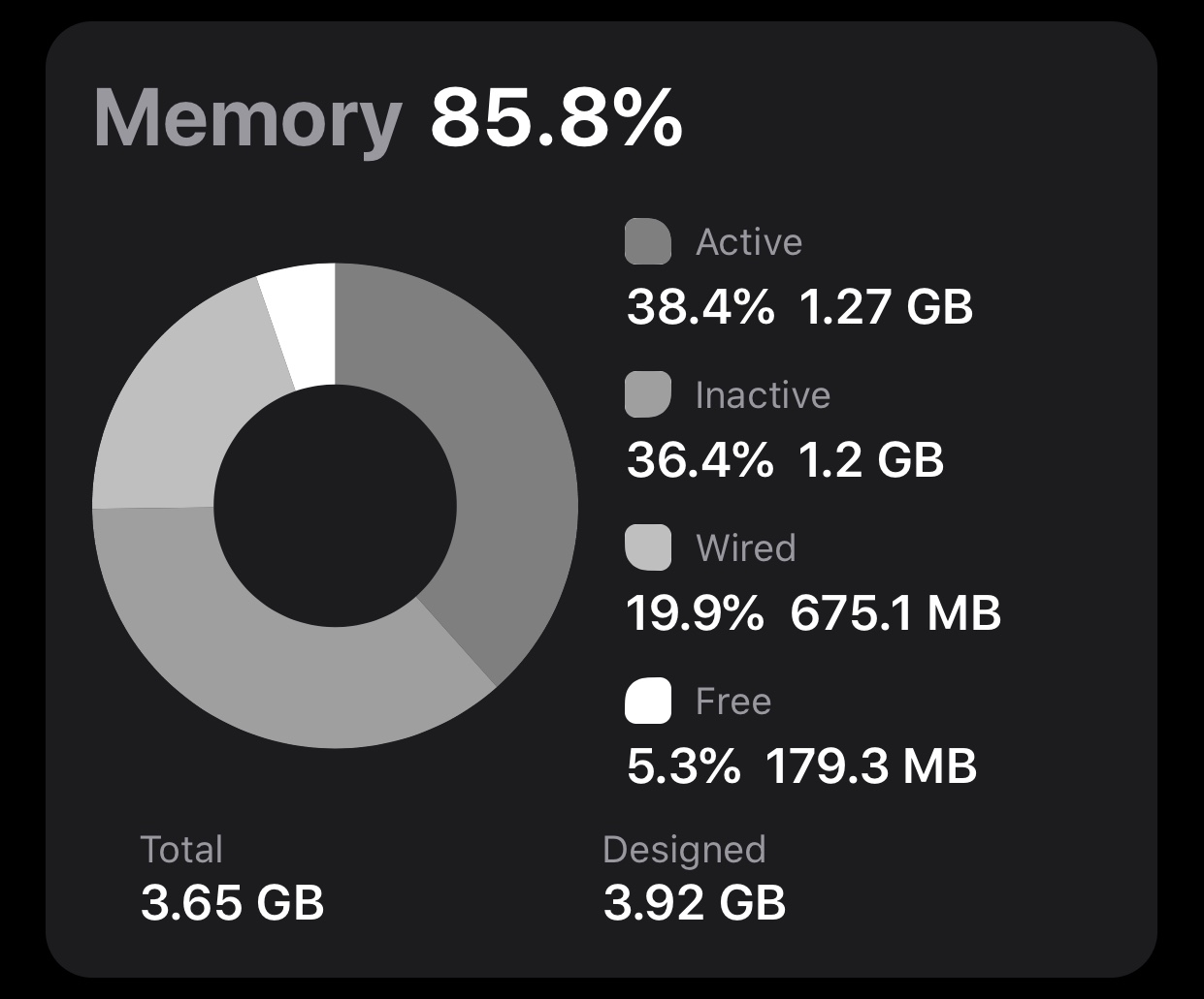

Also is it normal to have only 5.3% free memory with only safari opened on my iPhone?
