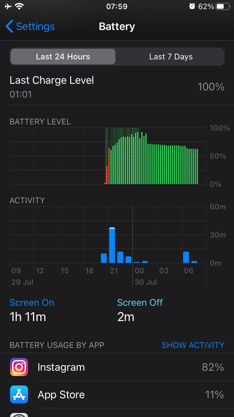

Hi everyone,
What’s everyone’s battery life on the iPhone 6S with IOS14? Here is a screenshot of mine.
Thanks

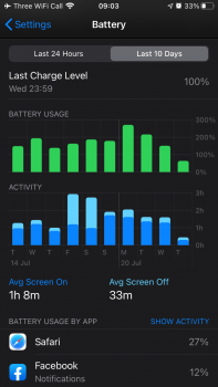

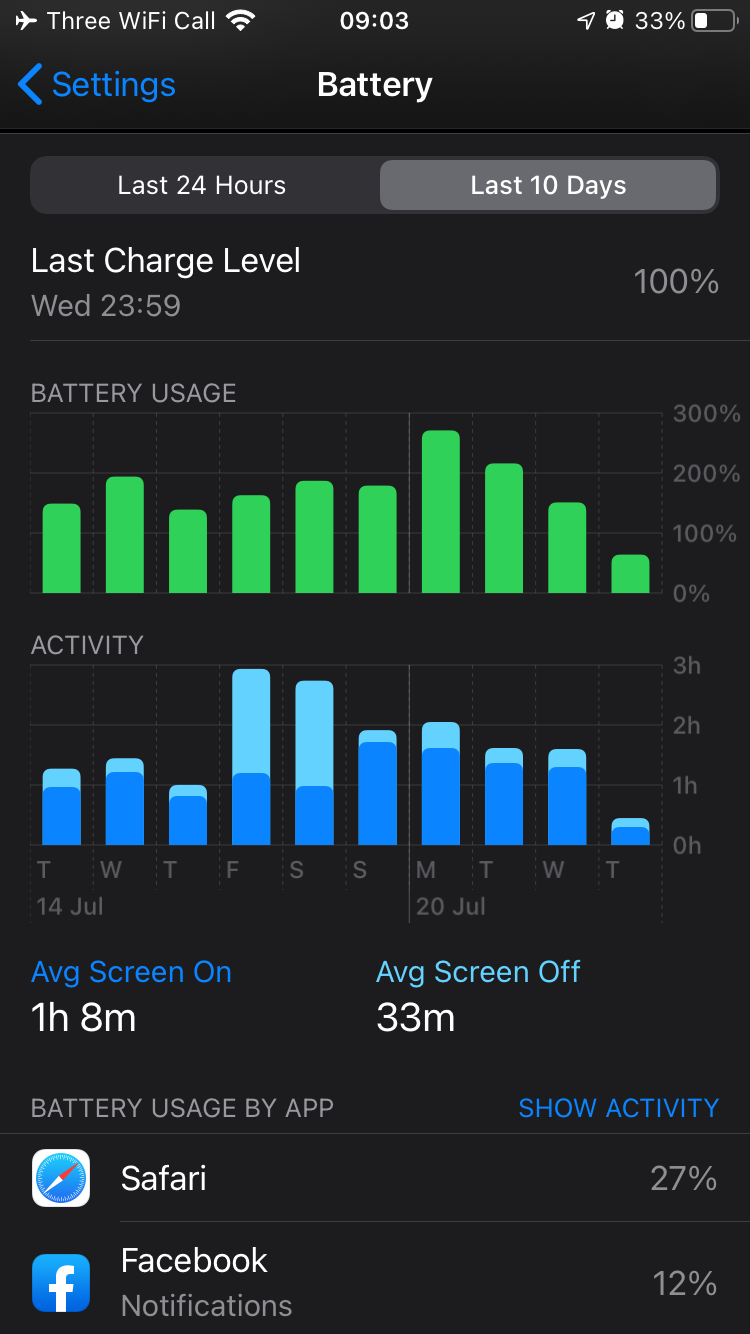

Just curious, could you screenshot your battery for the last days. It will be interesting to see how the battery compares.

Just checked my battery with coconut battery and it seems ok.
I can only assume the Beta is the reason for the drain. Annoying, but not much I can do. All the bugs I found reported via feedback. Roll on Beta 4 🙂

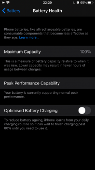

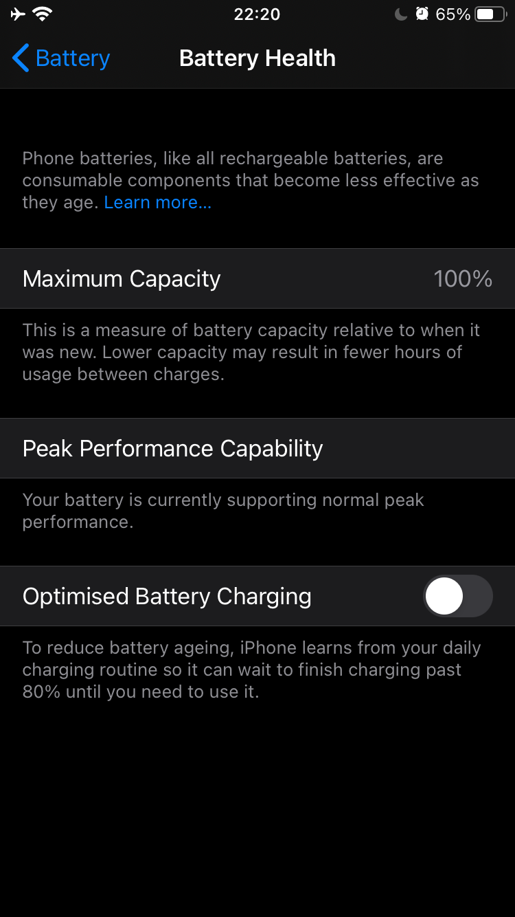

My only concern is why the battery is showing 100% capacity in the Apple battery settings when it is clearly swelled and faulty.
I only noticed since upgrading to iOS14, coincidence or maybe it was degrading for some time and I never noticed due to using a case.
So if you are getting poor battery life:
1. Apple battery health and coconut battery are not reliable indicators (both showed the battery as ok)
2. check for white patches on the screen
3. check for a bulge, lifted display
