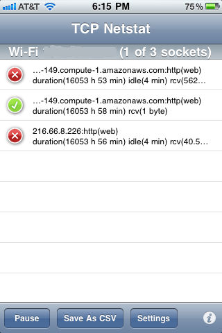

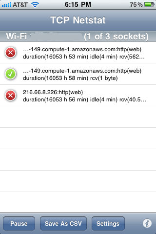

I downloaded that NetStat App and saw the appstore running and logged out of it and it was gone. Can someone tell me what these other ones are that are running in this picture?
Thanks
Thanks
Am I missing something? I don't see anything running.
