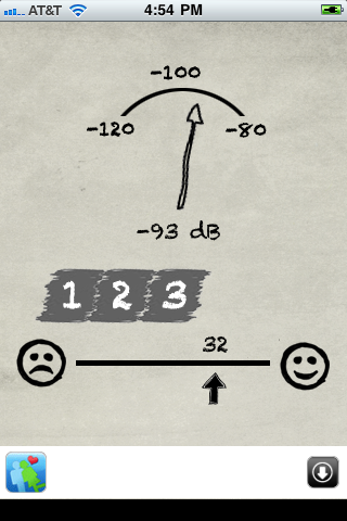

Does Strength give you information on which cell tower you are connecting to? I understand it will give you the dB level of the cell signal. What else does it give you? I'm having trouble downloading it now.
OK, I downloaded Strength from Cydia. It is a nice app that I recommend. It provides a simple drawing that indicates the cell signal strength and the corresponding number of bars.

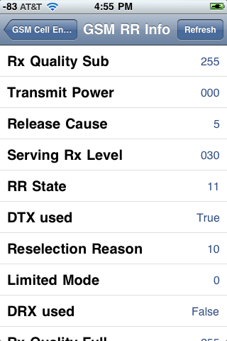

The FieldTest app is a whole 'nother thing. It is a tool for technicians and gives more information than you will ever need or understand. I believe it will show you the current tower and the other nearest towers. However, I only have one tower here! Screenshots of the the only page from Strength and one of many pages on FieldTest.

Field Test Modes are incredibly important to operators.

FieldTest.app is now back in iOS4.1 but Apple remove the FeildTest.plist in CoreTelephony.framework/Support so by typing the usual code it only shows the signal level. I try using the old plist from 3. and it becomes interesting: the 3GS shows full FieldTest with all pages while on the iP4 the menu is there but the page Neighboring Cells is blank, GSM Serving cell shows MA, BSIC, MA Dedicated ARFCN and C2 Value, the rest is unknown. Many network parameters are missing, the Neighboring Cells is blank while Signal.app shows minimum parameters for all 6 cells: ARFCN, BSIC, RSSI, C2 and Cell ID.
It is clear that FieldTest.app we found in iOS4 is not fully compatible with the iP4 hardware.
