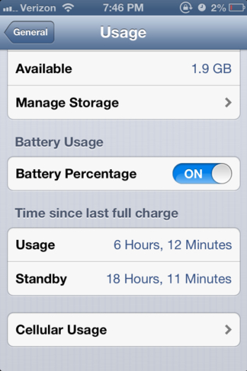

mine is doing pretty well.

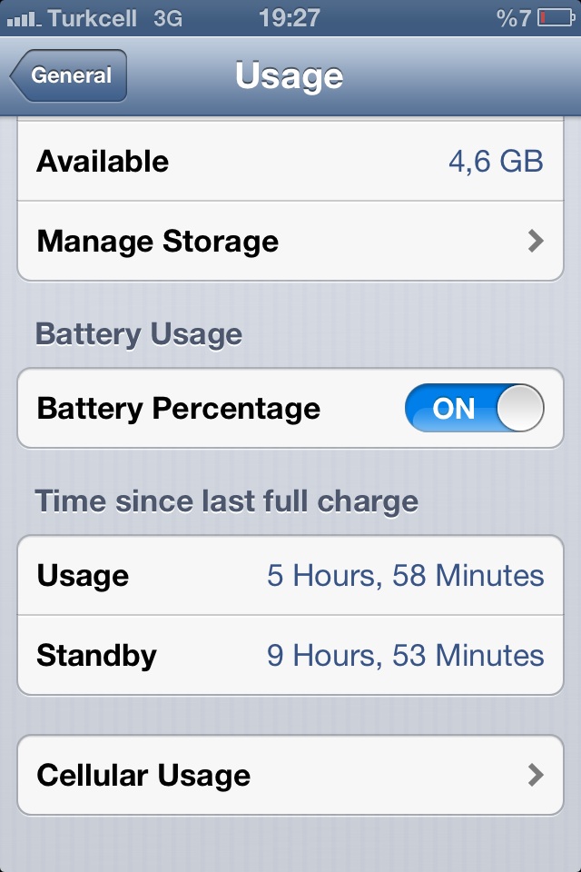

I really don't know what is wrong with my iphone 4s
During weekdays my battery seems to drain a lot faster compared to weekend.

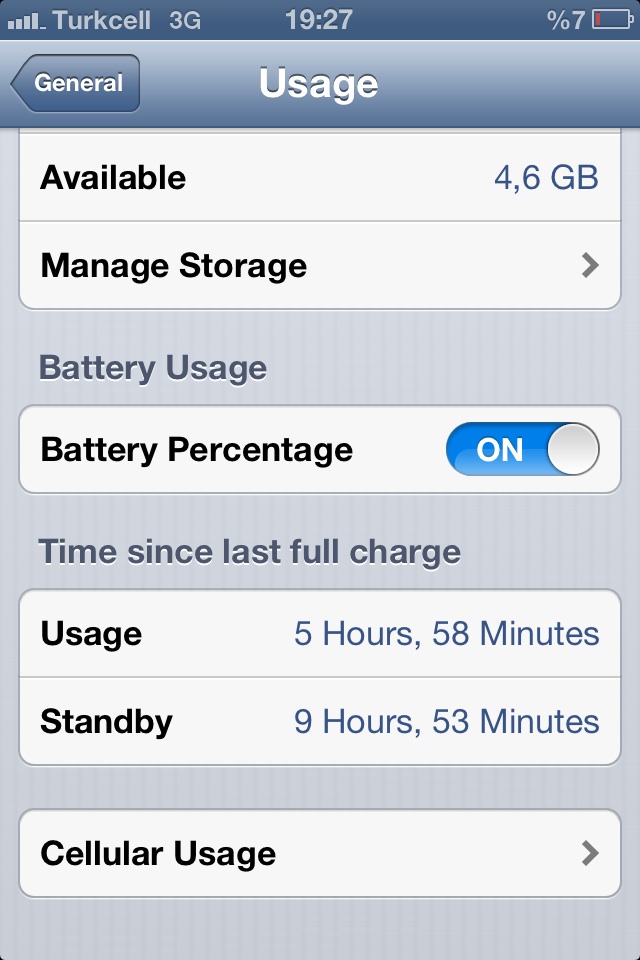

Here is today. I basically can't get through the day without my car charger. I have no idea what the problem is. Maybe the school network or sth?
Btw, this usage is just %90 whatsapp and 10% checking traffic to estimate when to leave. This is a huge problem.
But on the weekends i get about a day with 3-4 hours of usage. What's wrong?image.jpg

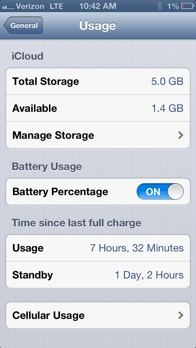

Mine got significantly worse. I was always at 6 hours 30 minutes to 7 hours of usage per day.
After iOS 6
I tried turning everything off and it didnt make much difference. So I did a restore. Tried it for a couple days and it seems a bit better.
I just turned off passbook's notifications and location setting to see if that helps some more. I hate having to disable crap to make my battery get me through the day.
