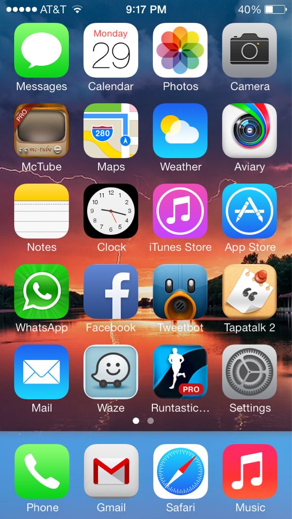

Yeah... I can't get the signal to go down. It's stuck on 5. (It's usually 4-5 at my house, but 1-2 at my aunt's, where it continues to be on 5)

I'm on T-Mobile iphone5 I ran the field test ( just dial *3001#12345#* in phone app). It sows -106 even thou I have 5 dots.

Same. Did the field test mode and I have -104, yet still have 5 dots of service reported. Something seems wrong here...
Just can't get it to indicate anything but 5 dots, when I know there should be less.

I just put my iPhone 5 into a metallic box(which I tested before with a bunch of different phones, they usually either lose signal or have 1 bar left(in the -100 range).My iPhone 5 did drop bars, so it's definitely not stuck!
Anyone else still experiencing this issue on Beta 5? I noticed the baseband and AT&T carrier files were updated but I'm still having the issue. 5 bars where I'm sitting where it used to be just 2...

Yes still showing 5 bars in a crappy signal area here too. Only affects 3G though, not lte or 2g

Yes. I show five "bars" at work when, in reality, I often have no signal at all.
