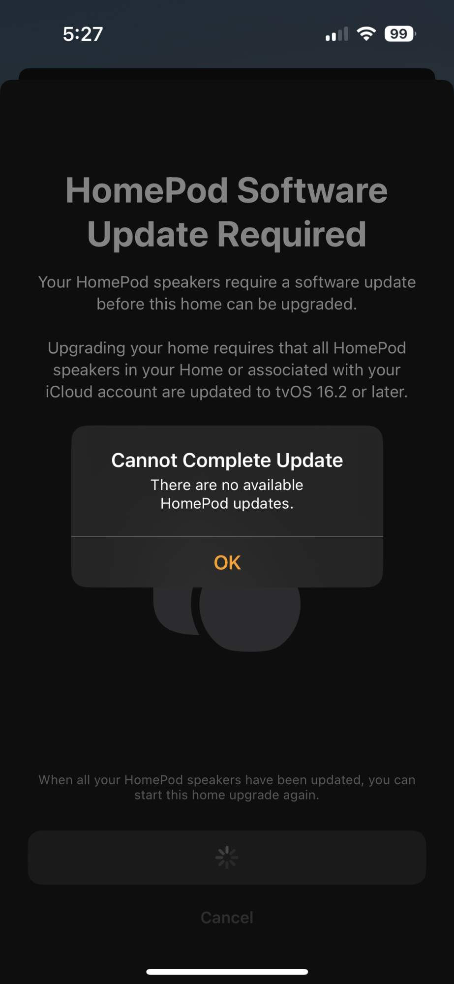

Has anyone else figured out how to get this to work? I have all my HomePod minis and Apple TVs in the house all on the latest 16.2 PB. I have OG HomePods that are stuck on 16.1 that don’t seem to have a beta of 16.2. My iPhone is on the latest 16.2 beta and my iPad Pro as well. I have other iPhones in the house like my work one that can’t go to 16.2, my wife’s phone and iPad and kids phones and iPads all on 16.1. Does this prevent me from updating to the latest architecture? I’m getting this message even though all HomePods are on 16.2 (except the OGs)
You need the OG HomePods on 16.2. Unlike for the Mini the beta for the OG is only available through the AppleSeed program, and there's no public beta. The beta switch in the Home app is for the public beta, not the AppleSeed beta.

I got around this by removing the OG HomePods from my iCloud. Upgraded HomeKit and then readded then to my network after the upgrade.
