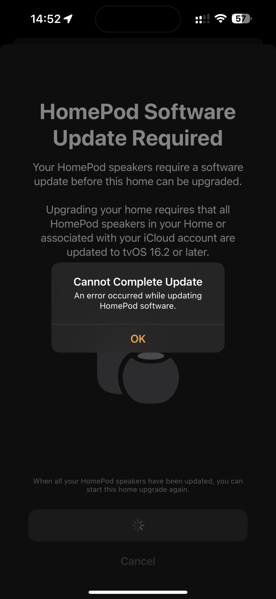

Upgrading your home requires that all HomePod speakers in your Home or associated with your iCloud account are updated to tvOS 16.2 or later.

Removed the HomePod mini, updated everything else to 16.2 and the Home update worked fine. I did it on my iPad, and it did say several of my other devices (iPhone, Mac, MacBook) would no longer work with Home as they weren't updated, even though they were all on 16.2. I took the gamble, but everything (including 5 HOOBS/Homebridge bridges) seems to be working fine, even Home.app on those listed devices. And even though it's early days and I've yet to test my automations, response seems to be much quicker, practically instant.If you remove that HomePod from your account by resetting it through the home app and also double checking in iCloud devices that it has been removed, then turn it off you should be good to go.
The question now is, if I re-setup my HomePod mini which is on 16.1 with no current option to update it, is it going to mess anything up, or will it just not function as a Home hub until it gets updated?
I've re-added it and it seems to function just as before, presumably it just doesn't serve as a Home hub any more. No option to update it to 16.2 though, still says it's up-to-date on 16.1.I would assume the latter - it might just not work at all with HomeKit. Also, wouldn’t surprise me if when you re-add it you then get the option to install 16.2.
Same problem here.I can’t even get to update my HomePods.
My phone, MacBook Pro, TV and iPad Pro are all on latest beta. HomePod Mini’s (have 5) are all enrolled in the beta prog although all are still on 16.1.
Yet when I try to upgrade it won’t and I get this. I’m in the UK if it makes a difference.
It is not as far as I know.Public audioOS 16.2 beta isn't out yet though, is it?
Same problem here.
I have the dev profile on my phone as that’s on 16.2 B1The latest AudioOS public beta (which the 'get beta updates' option refers to) is 16.1. You need the dev profile installed to get 16.2 - and counter-intuitively would probably need to also turn off the option to receive [public] beta updates if it's anything like the way dev betas work on ATVs.
