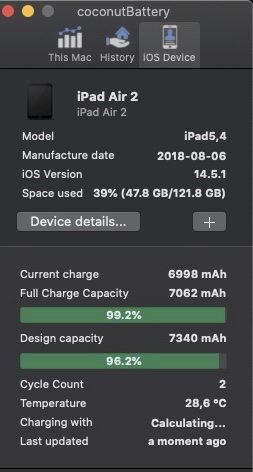

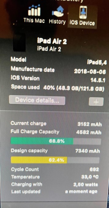

Here is the original battery (not fully charged when I took the photo) and the new one.
So i guess the new one has 278mAh less capacity then an original, but still 2477mAh better then the state of the old one, if I interpret these numbers correctly.
But if the difference is only 278mAh that wouldn't make the original battery last 10 hours as apple lists in the specs sheet?

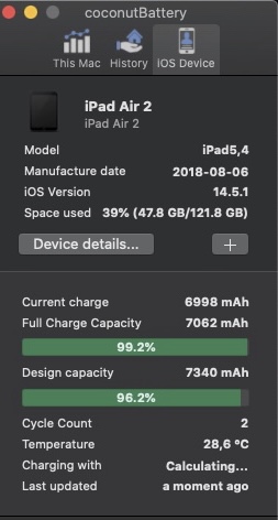

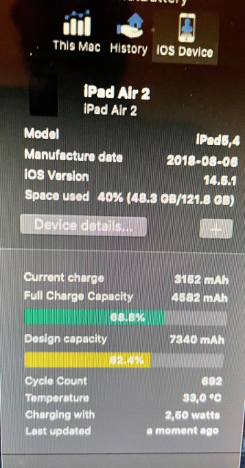

I have already seen this, while Apple battery are around 104-106% when new, these third party ones are under 100%. Also cells tend to degrade faster over time, but with the money they cost, you can change it again in a couple of years if necessary and still have more battery than the Apple one...
Yes, makes sense. Given that apple charge $140 for a battery change(Here in Norway) it's worth the trade-off.
But I still don't think a new factory iPad Air 2 would last 10 hours. They state "up" to 10 hours, so maybe with brightness turned way down I would last a bit longer, but still not 10. Maybe the new OS also drains more battery the with the launch OS like catcat98 said.
