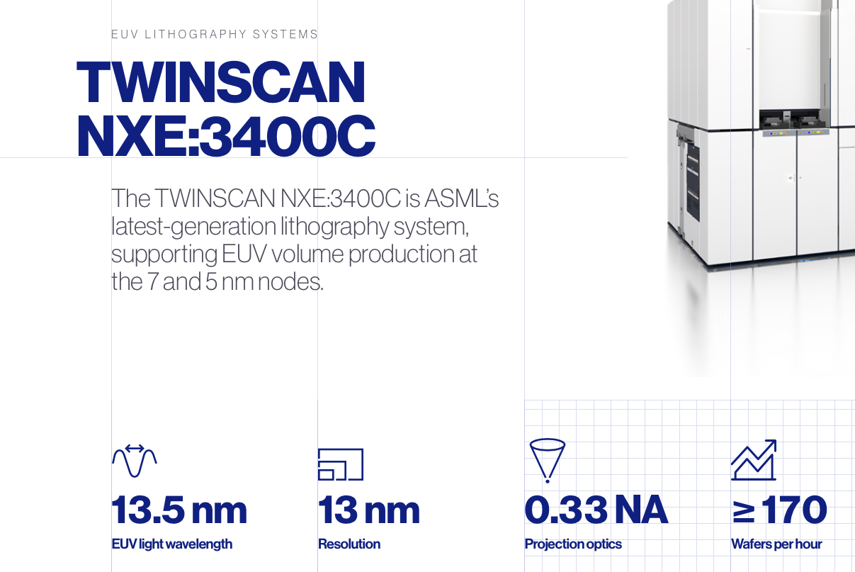

Not really cheaper. The technology for tooling a modern chip line has become so advanced and so expensive that even with the resources of the entire world, it's only possible to set up 2 or 3 next-generation EUV chip lines. The machines are insanely complicated - they use lasers to explode droplets of vaporised tin plasma, creating extreme ultra-violet light that needs to be focussed through mirrors to etch the chip - but the mirrors unavoidably absorb 96% of the light.
The power efficiency is around 0.02% so for each 200watts of laser light delivered over a million watts is needed at the wall. Each EUV machine weights 200 tons and only does about 40 wafers per hour, and costs over $120 million, and that is only a small part of what building a new chip line involves - but it's the main limiting factor.
There's more or less only one company that makes them, ASML in the Netherlands, which was formed from a consortium of almost all the research companies working in this field - because the expense and difficulty of developing them was so extreme. So far, I believe there's only around 100 of these EUV machines worldwide, and ASML is working flat out to refine and make more of them.
As you said, it costs around $20-100 billion to set up new chip lines, and the next generation is likely to be even more expensive. It may be that from 2025 onwards, every chip company in the world will have to jointly collaborate to fund a single next-generation line with huge government funding - the costs are just too extreme otherwise.
Good post, except you got the numbers of wafers per hour wrong.
Equal or greater than 170 per hour, last time I visited I read it can go up to 250 per hour.
These are huge, you can see the size in the this video from ASML, right at the beginning.
