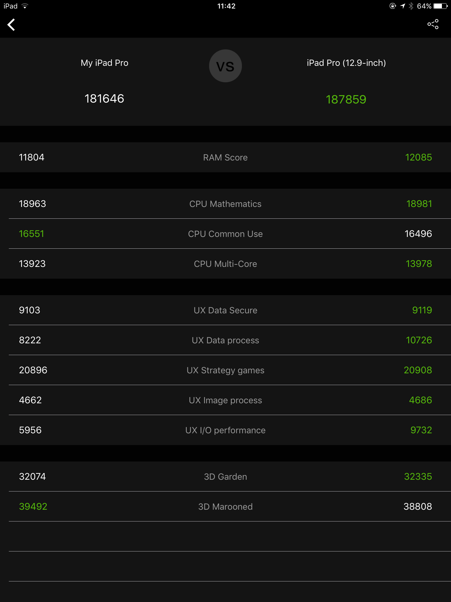

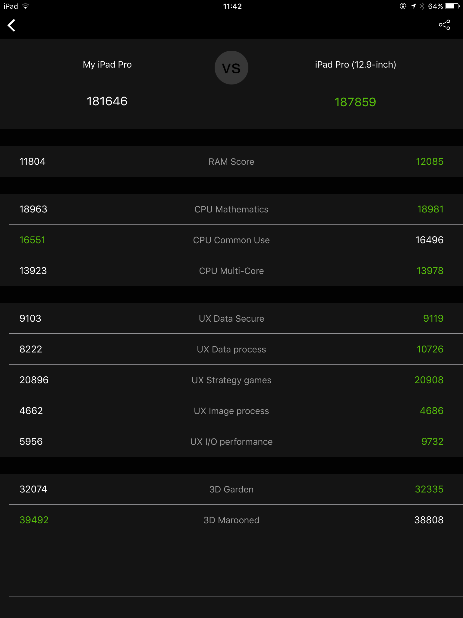

[doublepost=1514574332][/doublepost]I reran Antutu 6.3 with my iPad plugged into charger, got very similar results.
It seems that if Apple's throttling rationale is to prevent sudden shutdowns or conserve battery power, then all devices should be allowed to run at full, unthrottled speed when they are plugged in???
Why is my iPad still just as slow when plugged into wall power?
Antutu v6.3 screenshot attached
Note, you're comparing a 1st gen iPad Pro 12.9 (A9X) with a 2nd gen iPad Pro 12.9 (A10X).

Thank you, you are right. Maybe there is just a defect with my iPad Pro.
The only test score that is substantially out of line is the UX IO, when compared to the average of 1st gen iPad Pro. Plugged-in or not did not change the results.

You have 6GB free space out of 128GB.
Might be worth doing an iTunes encrypted backup/restore to free up cached storage and maybe force a SSD secure erase or TRIM.

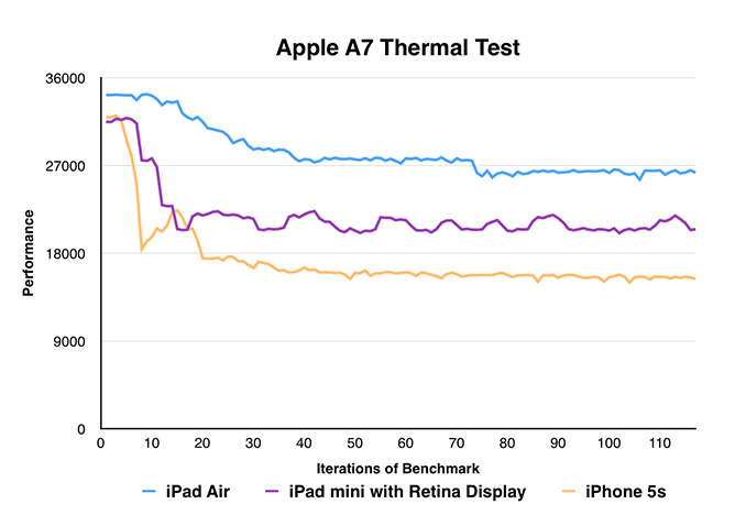

Here is my iPad mini 2 slowed down a little bit at 57% battery. Current Frequency is 1300MHz vs. 1400MHz.
I believe 1.3GHz is the normal frequency for the mini 2.
https://www.anandtech.com/show/7519/apple-ipad-mini-with-retina-display-reviewed/2
The iPad mini with Retina Display rounds out the three platforms that use Apple’s A7 SoC. Although both the iPad Air and iPhone 5S use the A7, the mini’s implementation is closer in nature to the iPhone. The iPad mini’s SoC has always used the same package-on-package (PoP) assembly as the iPhone, with DRAM stacked on top of the SoC itself (1GB in this case). The benefit is obviously a reduction in board area, the downsides have to do with cost and thermals. That’s the first similarity between the mini’s A7 and the iPhone’s A7.
The second is one of frequencies. While the iPad Air’s A7 runs its two Cyclone CPU cores at up to 1.4GHz, the SoC in the iPad mini and the iPhone 5S runs at up to 1.3GHz. That might sound like a minor difference, but it’s far more pronounced when you look at what happens to frequency when you’re running heavy workloads.
Once again I turn to a fairly heavy CPU workload to plot performance over time. This is a multithreaded workload, slightly modified from what we used in the iPad Air review, designed to make the CPU cores consume max power. The scale is linear and the workload is the same across all devices, so what you’re effectively looking at is a graph of thermally bound CPU performance over time across all three A7 implementations:
Being the largest device (and the only device with a metal heat spreader and no DRAM stacked on top), the iPad Air obviously maintains the highest frequencies for the duration of the test. The iPhone 5S, with a significant reduction in internal volume (and a PoP SoC) reduces its CPU frequencies early on in order to keep skin temperature down and properly manage thermals. The iPad mini with Retina Display falls between the two, with its performance curve more closely following that of the iPhone 5S.
Although the mini has a similar max operating frequency to the iPhone 5S, it is a faster device thanks to it being less thermally constrained. Similarly, the iPad Air can be much faster than its clock speed would otherwise imply. If you’re wondering why Apple has been so focused on building its own SoCs and CPU architectures, this is the reason why. There’s a fixed amount of power you can dissipate in the form of heat in these mobile devices while still maintaining a good user experience. Performance per watt is the gating metric for success in mobile, and shipping high IPC/low frequency dual-core SoCs at 32/28nm is the best optimization available to a company like Apple today.
