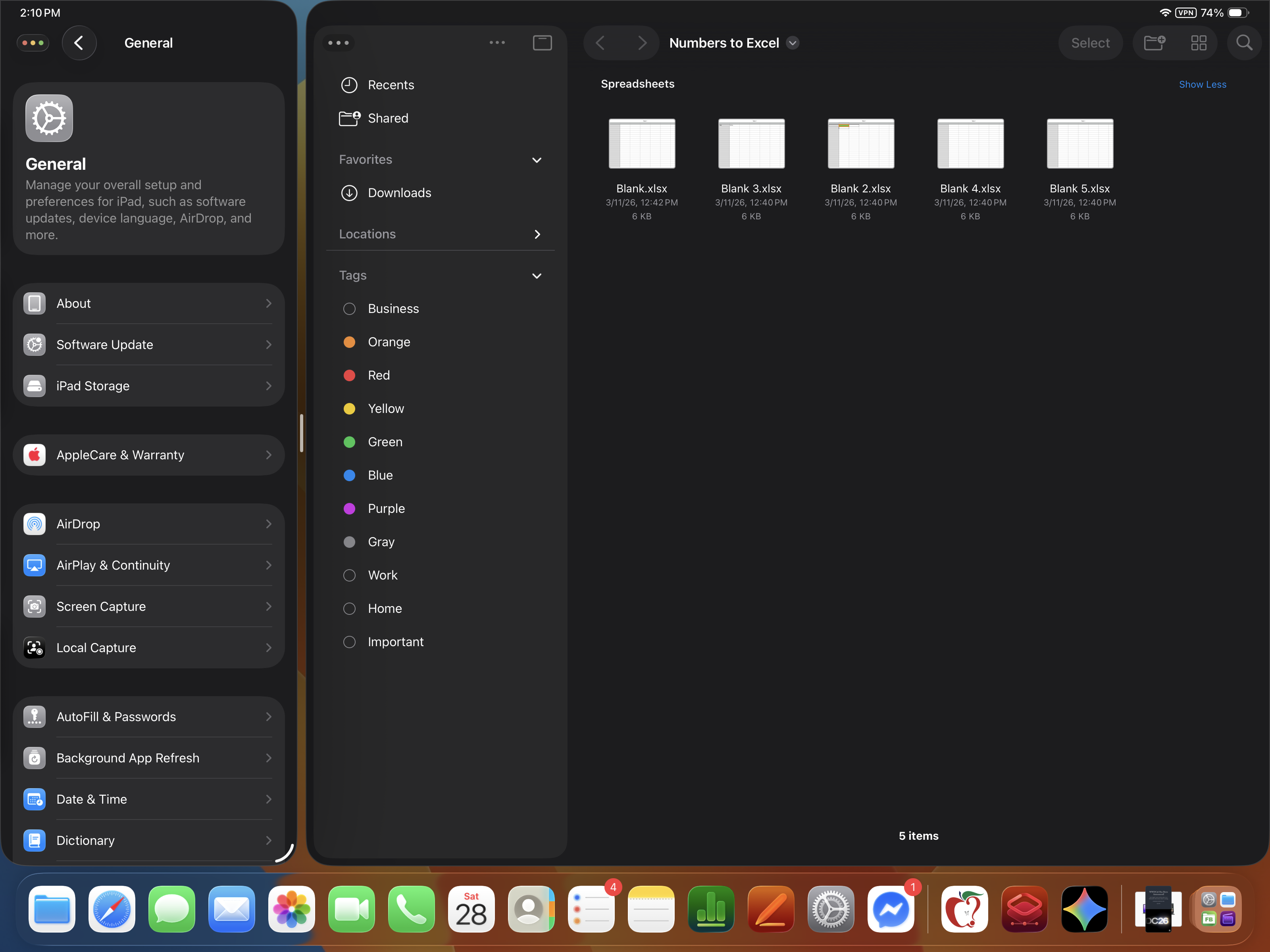

If you already have one of the apps open you want in the Split View, you can add it to Split View in several ways. The primary gesture method is kind of flicking the app window to the side of the screen you want it on. You could also add it to Split View by selecting the appropriate option in Menu Bar > Window > Move & Resize. “Arrange” options in this menu also allow you to create an automatic Split View from several already open windows. And another way to create a Split View is by hold pressing the traffic light window button, and selecting the desired Split View option. This is the option I use most often, as it’s very similar to the way the prior Multitasking Menu gray dots interface used to work. Once you have one of the apps in the Split View setup, you can drag the other one in from the App Dock just like the older iteration. And as I mentioned before, if two app windows are already open, you could also use the window options to arrange both into a Split View. I hope that helps you out. 👍🏻
Okay? So tell me the steps I will try it when I get home. Because I really want to try it.
@Kal Madda already explained most of the ways but I think there is a method that may be the closest to how it used to be in iPadOS18 and what was brought back.
If you have an app already in full screen, just drag and app from the dock (or if you search for it) to the left or right of the full screen app and once you do the full screen app will shrink a little and there will be a little “panel control” that will slide out. If you drop the new app into the open space the apps go into split screen. If you drag onto that panel control, that app you were dragging goes into Slide Over, replacing the original one. Once you are in Split View, there is a control in the middle to adjust the sizing of the windows.

Edited to add: I updated to 26.4 and I have been messing with it, and it does seem like if you drop the window in the upper middle quadrant of the app size you want, it tries to match, if it can. This is helpful. I'll keep at it. Maybe I will get there.
