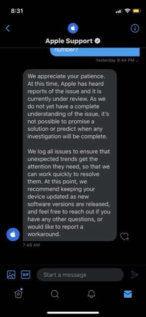

I also got in touch with Apple Support on Twitter and got a similar reply, so I guess it's at least under investigation.
In terms of the display being unresponsive on lock screen, we’ve heard reports of the issue you're describing, and it’s currently under review. We don’t have a solution at this time, but recommend that you keep your device up-to-date using Software Update.

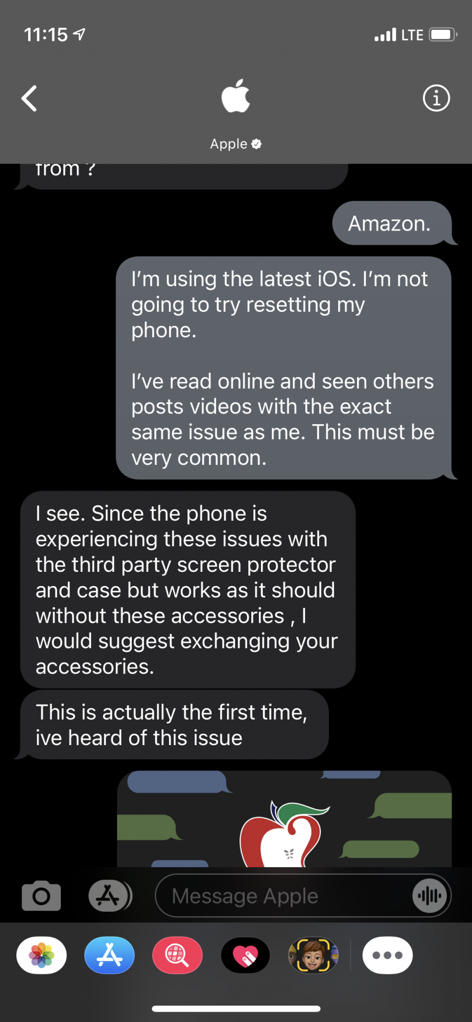

lol companies will never call it a hardware issue unless they have no choice, otherwise they lose out so much money for recalling a bunch of iPhone 12 minis AROUND THE WORLD. I just hope they find a fix to this solution via software.

Is this happening ONLY on the mini? If so, I want to return it before my 14 days are up. It’s annoying as I don’t like going caseless or without screen protector...

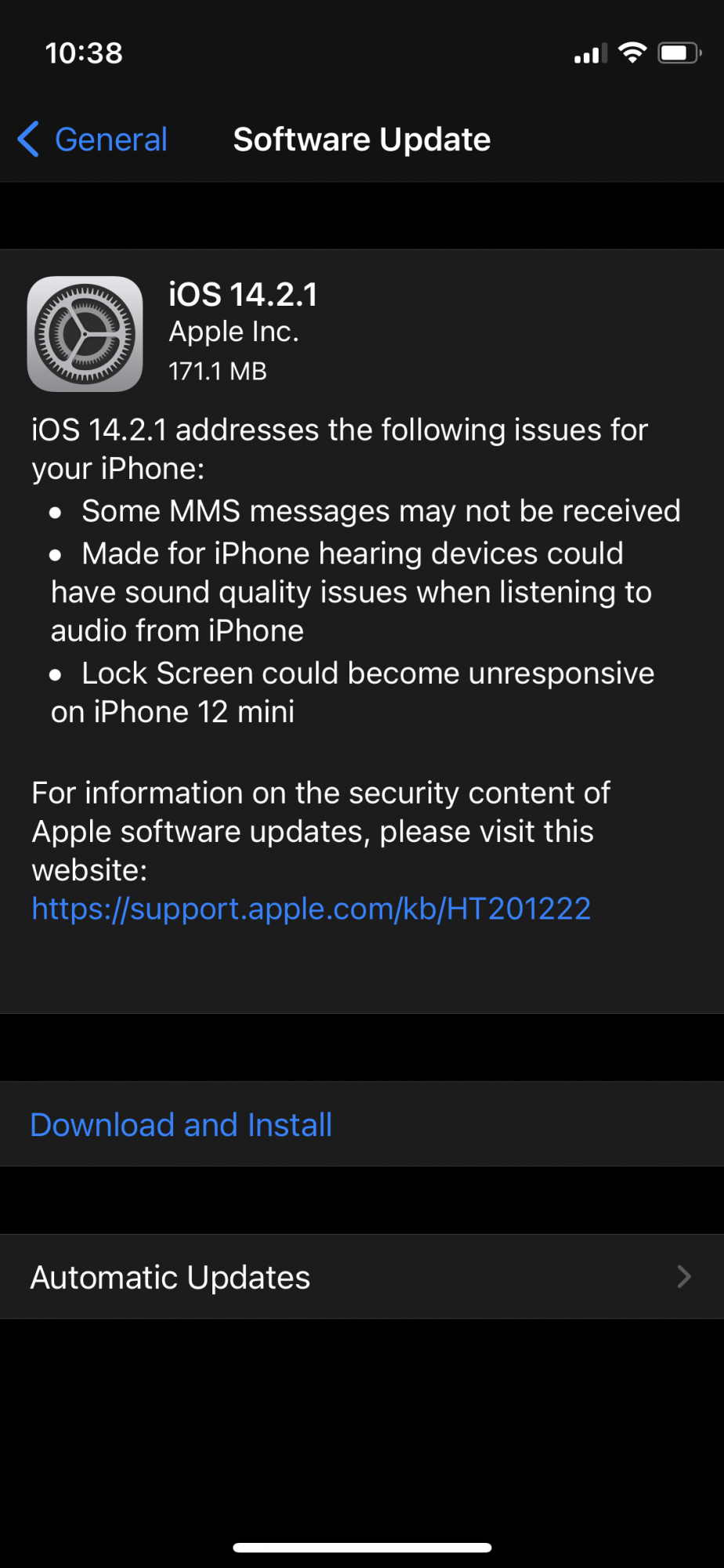

Has this worked then for those that have updated?
Just updated my mini, no issues opening the camera and flashlight or swiping to answer calls with my left thumb anymore. I also have the silicon case with a glass screen protector. Issue is fixed on my end.
