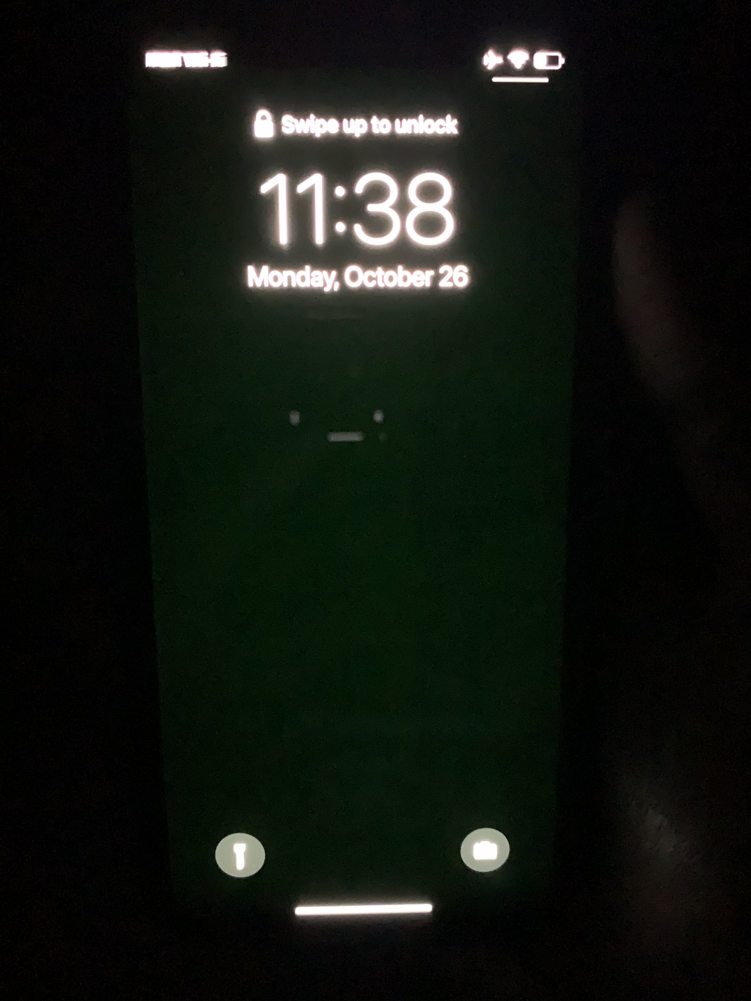

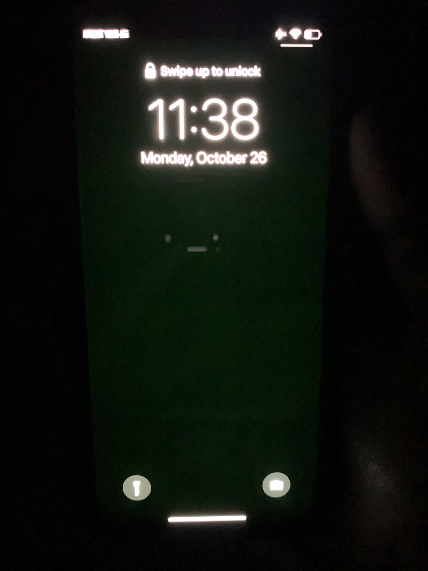

I did notice something while testing though which was disappointing. I always have Apple’s all black wallpaper for my Lock Screen to save the AMOLED panel over time and battery life when I get notifications. When I picked up my 12 Pro I saw this at about 30% brightness. My Xs Max was pitch black throughout its entire brightness range.

I tried it but wasn’t able to discern a noticeable difference. Do I need to wait ten seconds after toggling the auto brightness on?
When you turn off auto brightness, it takes a few seconds for the brightness to start ramping up. You are making sure that before disabling it, you have got your brightness set to maximum?
Yes, True Tone off as well and I’m just in settings. I’ll try again.

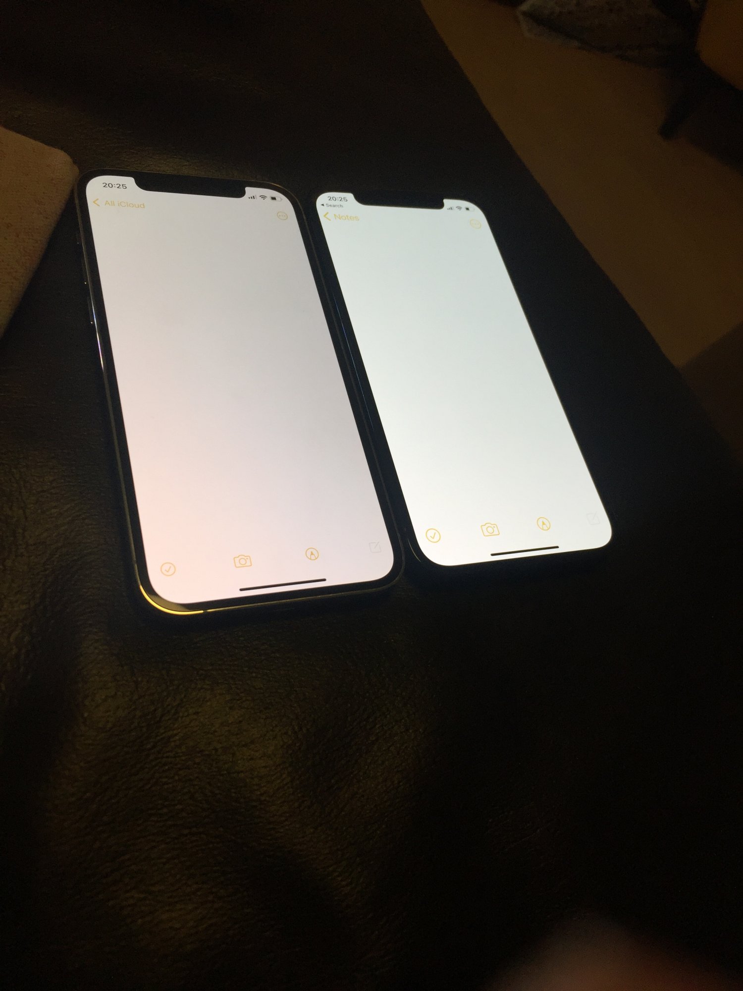

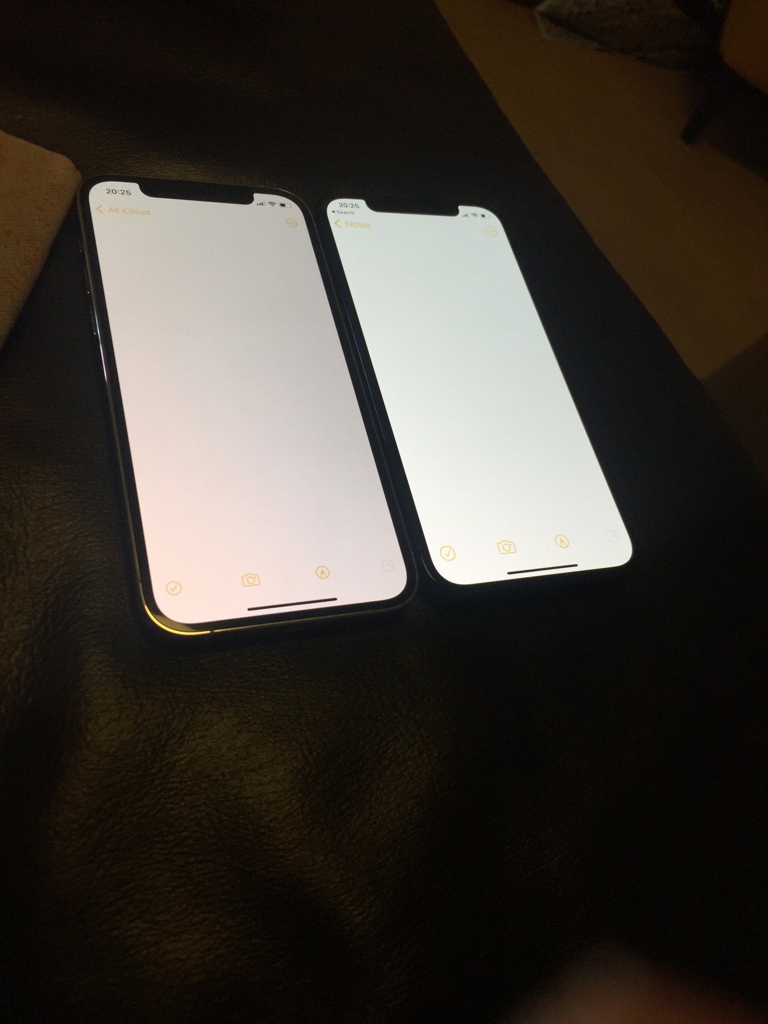

I've got two identical spec 12 Pros (other than one being silver and the other blue), and with exact same screen settings one is noticeably dimmer than the other. The dimmer one arrived 10 days after the brighter one. By turning down the screen on the brighter one until they match, then examining the increments of the brightness slider, it looks about 14% brighter.
EDIT: Thanks to this thread this problem has now been solved by the disabling the buried auto brightness setting in accessibility>display & text size!
If there is no difference in brightness, your phone is normal. He’s giving you incorrect advice.
Don’t believe either of us. Visit an Apple Store and check out 5+ OLED iPhones for yourself.
