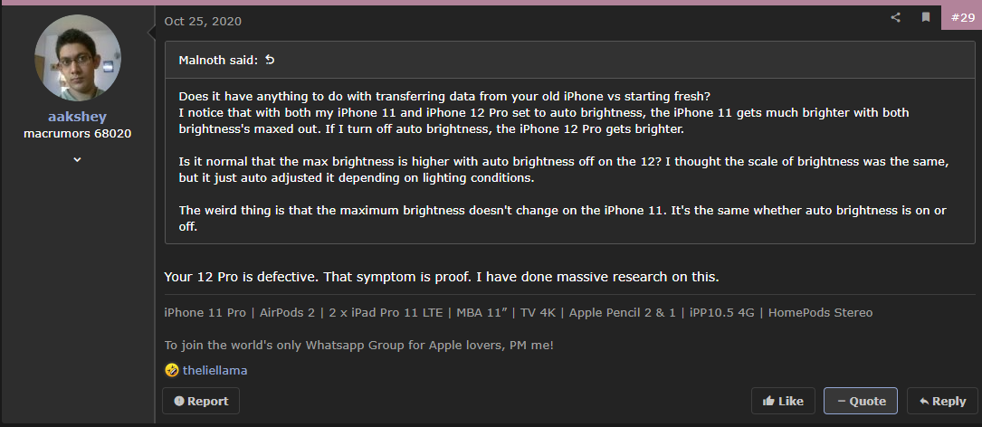

Malnoth : Great. Only difference between 11 and 12 (or LCD and OLED) is that maximum brightness in dark enviroment is lower for 12 (something like 90% of 11 / LCD).
You notice higher brightness for 12 Pro ? (800 nits)
But aakshey in few pages claim that are faulty devices...

With auto brightness turned on, brightness set to max, and in a dark environment, the 12 pro is dimmer than the 11 with identical settings. If I turn auto brightness off on both, the 12 pro becomes much brighter.
aakshey is the only person I have seen who keeps saying these are faulty devices.
I have confirmed with other members of macrumors that this behavior is expected for OLED iPhones, as well as personally tested an iPhone 12 pro, 12 mini, and 12 Pro max. They all function the same way.
He has even confirmed that when brightness is set to max, turning off auto brightness increases the display brightness.
He now claims that it's only when the brightness is less than 100% that it should not get brighter when auto brightness is disabled. I don't believe this to be the case for OLED iPhones. For OLED iPhones it doesn't matter what level your brightness is at when you disable auto brightness, the limited brightness 'range' will adjust to the new full range. It is most noticeable when the brightness is at 100% already, but it still occurs regardless.
The major difference is that the way auto brightness behaves is different for OLED and LCD iPhones.
For LCD iPhones, the maximum brightness is the same whether auto brightness is turned on or off.
Therefore, disabling auto brightness will not increase the brightness.
For OLED iPhones with auto brightness turned on, in dimmer environments the maximum brightness is reduced.
Disabling auto brightness WILL increase the screen brightness.
You will only hit the true maximum display brightness when the ambient light sensor determines you are in such a bright environment that it needs it. For example, outside in direct sunlight.
If you turn off auto brightness, you will be able to hit the maximum display brightness by simply increasing the brightness to 100%.

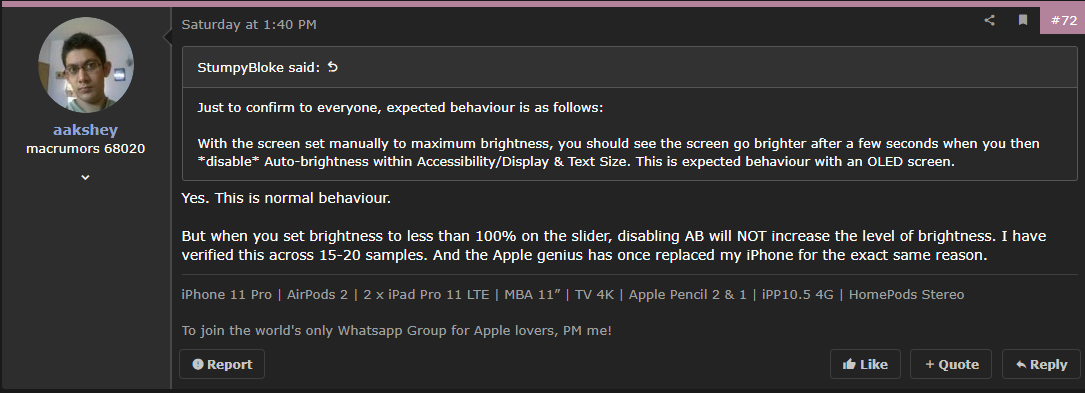

You‘re doing it wrong. I asked you to test at less than 100% brightness. And I didn’t ask you to compare 2 iPhones. Anyway, best of luck.
Which part am I doing wrong?
Earlier in this thread you immediately told me my 12 pro is defective when I did the test at 100% brightness.
Now you say it's only when it's less that 100% that it's defective. Which is it?
Reactions: gtg465x
I always asked you to test at way lower than 100% brightness.
How can you state this with my post above where I literally explained my test is being done at 100% brightness and you immediately stated it's defective.
Please do this test on your 11 Pro and tell me your results...
1. Go into a pitch black room.
2. Turn on AB and set brightness to 90%
3. Open a safari window and go to google.com so you have a nice white background to compare.
4. Turn off AB and immediately switch to safari.
5. Wait 30 seconds.
Your display will get brighter.

I might have missed what you wrote.
My 11 Pro is defective. That’s why I know. I have owned many iPhone X units in the past (all fine except one) and also tested this on many units in store.
So I know.
My Pro is defective so doing your test won’t help you. And I don’t have any other OLED at my place.
I do know healthy Apple OLEDs and LCDs work the same way. From extensive tests that I have done on both.
You’ll need to go to an Apple store to do the above test. It doesn’t necessarily have to be pitch dark. But you shouldn’t be directly under the sunlight either.
Ideally keep brightness around 50%, take or give, but not essential.
As long as you’re indoors (even if there is some sunlight, but mostly artificial light or darkness), the test will be credible.
As to why I can’t exchange? Because service sucks in India and there are no returns. Unless it fails their diagnostics, 99% they just send it back to you.
In India they don’t try to manually understand problems 99% of the time. It’s just the diagnostics.
Earpiece not working - Buy a new one unless it fails diagnostics.
There are no Apple stores in India. Just Apple authorised service centers which suck.
And in my case the problem isn’t severe. 90% equals to real 75% for me. So not as big a deal. Something I can live with. Nothing I need to fight over.

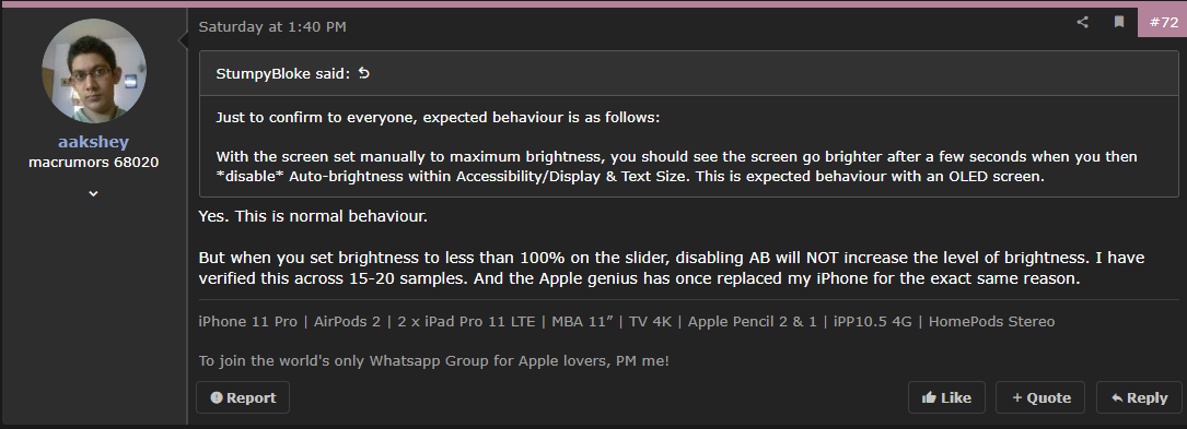

So I know.
So we are both in agreement that if you have an OLED iPhone at 100% brightness with AB ON, and then you turn it OFF it gets brighter. Correct?
That's already a difference between OLED and LCD iPhones.
An LCD iPhone in the same scenario does NOT get brighter.
If the max brightness changes for OLED iPhones at 100% brightness when AB is turned OFF, doesn't it make sense that the brightness would increase no matter what percentage the brightness is at? You are simply removing that soft brightness range when you turn off AB.
1. yes
2 yes
3 no, sounds good in theory. But isn’t that way in reality. I have tested it across so many many phones.
Please test it across 5-10 phones, I’m betting the majority won’t show an increase in brightness. But few might. Because the problem is very widespread with Apple’s QC for OLEDs.
Test a big enough sample and I’m guessing the defectives ones might be as few as 5% or as high as 20%. But the vast majority will be defect free.

I have personally tested an iPhone 11 Pro, 12 Pro, 12 Pro max, and 12 mini.
They ALL increase in brightness.
This is not a defect, it's functioning as designed. @Gus_BZ is 100% correct.
