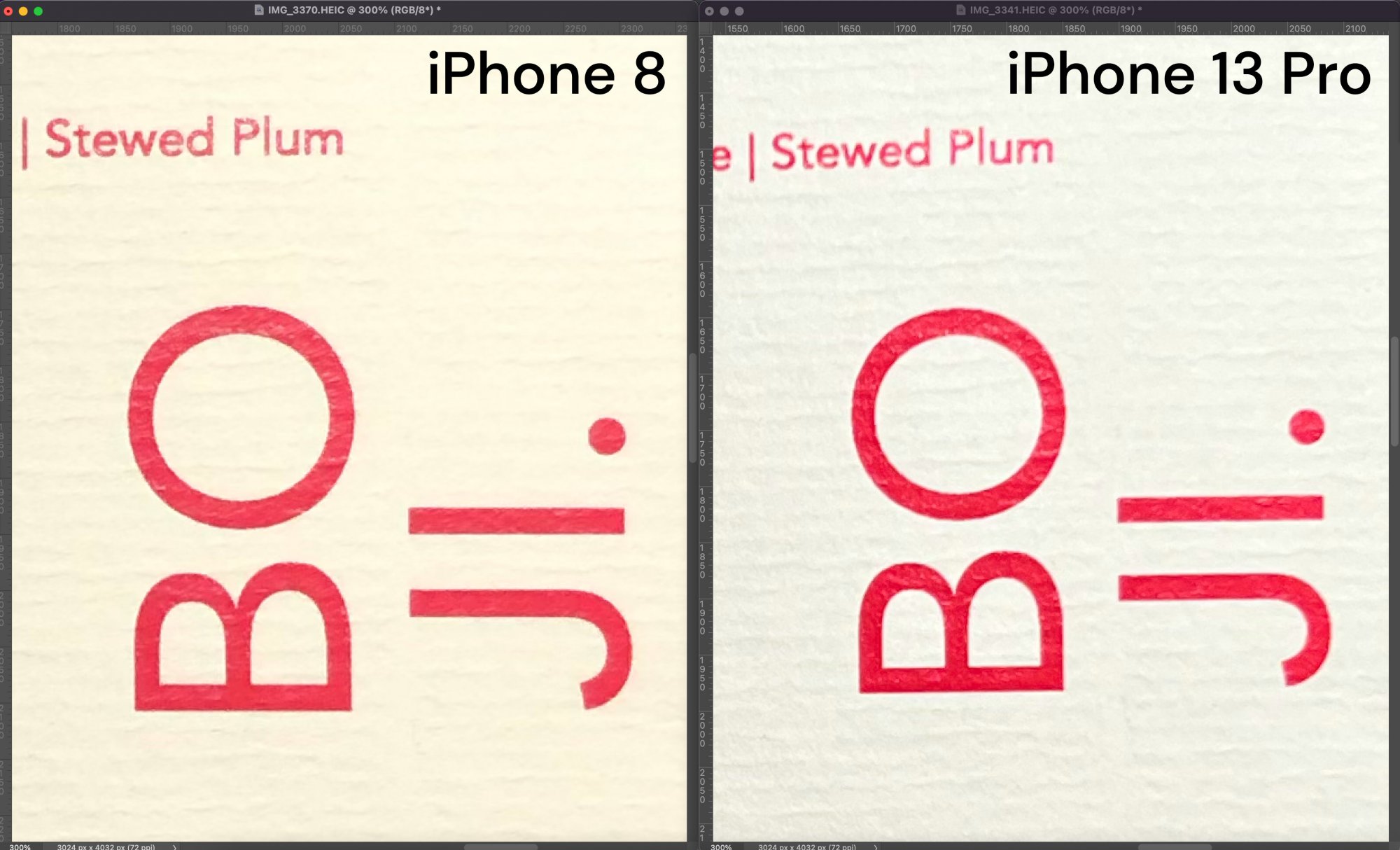

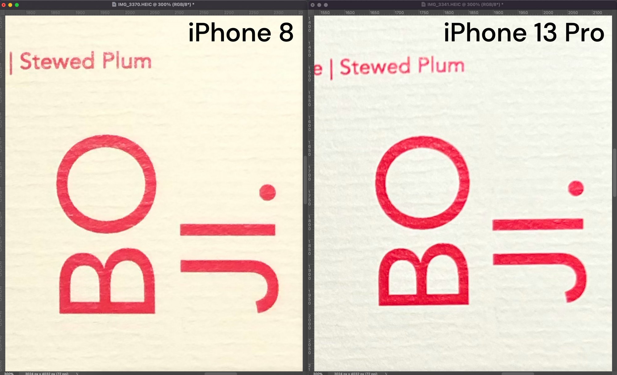

I have a 13 Pro and almost instantly I had a feeling that my old iPhone 8 was sharper. I did some tests and indeed it is. I also read of others noticing it, so it's not a problem of my unit. Do you have an older iPhone to compare? Images look slightly out of focus. The RAW image taken with apps like Halide are even softer. It's better in terms of HDR and noise levels, but not sharpness. Am I alone? I attach one of many samples. This could also be seen on the macrumors articles (looking at rocks for example). I did many tests, it's not a DOF problem, images are steady and on the same plane of focus (I'm a photographer). There's a lot of post processing in the 13 images, that almost makes them look sharper, but in some areas it's clear that in my case the 8 captures more detail

iPhone 8 might be applying more sharpening effect after the fact in post processing than the 13. If you magnify to picture to max and examine the boundary between two contrasting colors, the one that has more highlight to the edge was sharpened more after the fact by the camera software.
I have both an 8 and 8+ and the pictures they take look a bit too over sharpened to me.
I checked the RAW pictures of both, and the 13 is still softer, so we can rule out post processing

Looking at the samples provided here and in the dpreview thread, it's pretty perplexing to me, at least in a way that it's hard to conclude that it's an optical hardware problem. It almost seems like there is something being done with contrast interpretation (aka sharpening) at the raw level. Design choices at with optics can prioritize things like highlight/color rendition vs absolute resolution, but it's really hard to make any conclusions with so much behind the scenes processing going on (even in raw). The OP example here almost looks like a focal plane issue, but the other examples should be well within DOF.
Personally, I don't think it's a big deal, but I am certainly curious to know what's going on.

In general DOF plays a big role. But in my examples the focal plane is correct. Meaning that there's a "maximum" sharpness attainable with the iPhone 13 Pro 1x lens, and this maximum sharpness is worse than previous iPhones. The effect is the same of when you use a cheap lens wide open on a real camera. We all know all cheap lenses perform better when stopped down in aperture (like f/8). In the iPhone the diaphragm is fixed for every lens so you can't "enhance" the optical rendition of the lens and the depth of field, at the expense of light. So you're stuck with full aperture performance. I think it all is a compromise in the end. Bigger pixels and lens means more light, faster shutter speeds, better low light results, better noise levels. They probably decided to lose some sharpness and apply aggressive sharpening in post to counter this. If you manual focus in Halide, just looking at the loupe makes it apparent how you can't get more sharp than that. As you move the slider you just go from out of focus, to somewhat in focus, to out of focus again. I mean, RAW images aren't THAT worse than the iPhone 8, but for sure there's less detail in there. Sometimes though the 13 still performs better, because in the 8 if there's noise the detail is lost anyway.

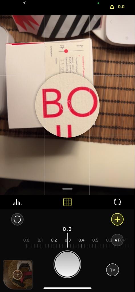

what app is this? this doesnt look like the stock app. i dont have blurriness issues, only for macro shots with the vignetting on the outer perimeter
It also happens with the stock app
I used other apps to get access to RAW images file thus ruling out any post processing and only evaluating optical performance

I tried manual focus with Halide. It doesn't get better. It's the optical design of the lens in my opinion. Bigger sensor and bigger aperture lead to less sharpness. Like a cheap reflex lens used wide open

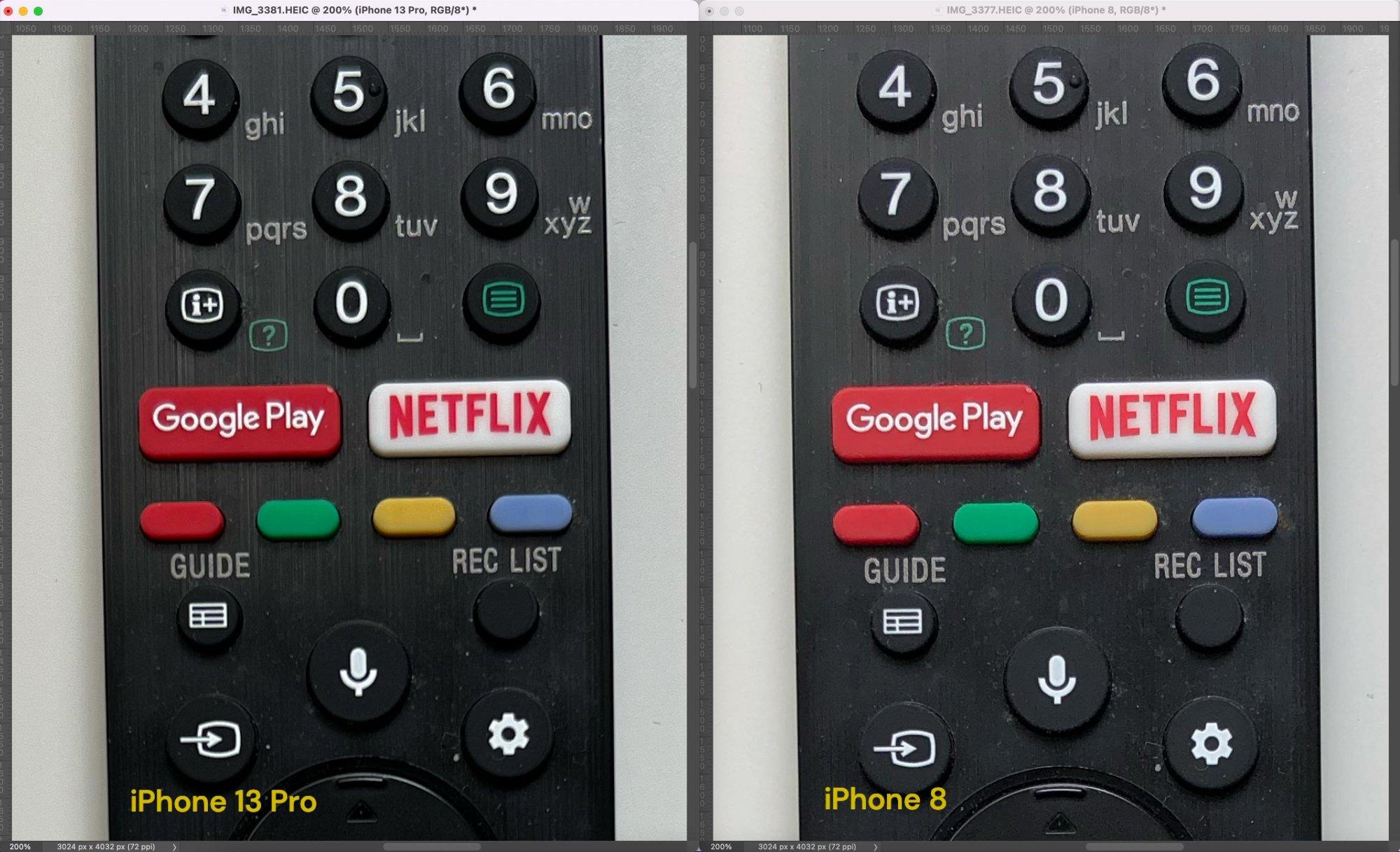

Just did another test. It's particularly bad in close-is range. You can see some "doubling" in the number in the upper part (this is a crop, the center of the photo is roughly on the bottom of the image. Softer buttons too
