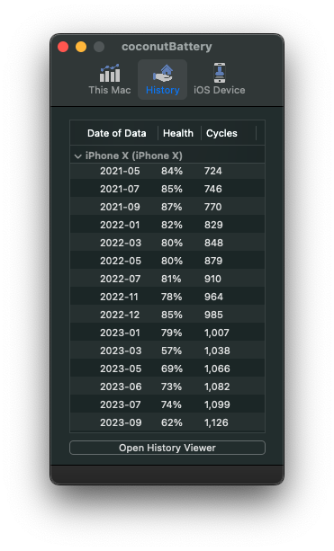

A little more than five years and about 1000 full charge cycles to drop below 80% estimated battery health. (iOS currently estimates 75%.)
Coincidentally, the 79% in the Jan. 2023 log was the same as what iOS was reporting.
With that said, I think, it’s time for another reminder of how battery state is far from simple, it’s an ongoing guesstimate.
