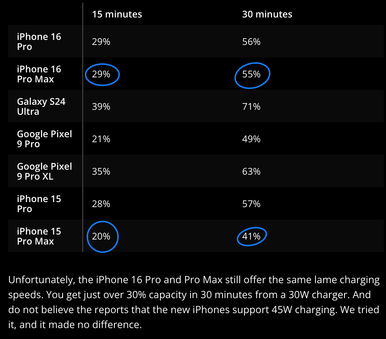

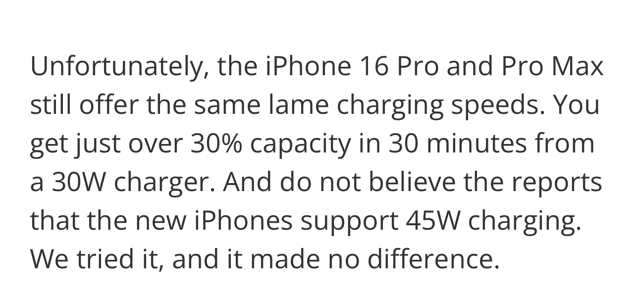

this is from the tomsguide review yesterday?
Did you read my post? The chart right above the paragraph you posted seems to disprove their claim. See attached.

I don’t think any reviewer has been able to confirm this - only getting around 30W max but they are terrible reviewers
PetaPixel's review noted that the charging upgrade only kicks in for heavy usage + charging at the same time.
Then, this Medium post (paywall removed)
The charging power of the iPhone 16 series is far from the hype. Under extreme conditions, the iPhone 16 Pro Max sustained 33W of charging power, with momentary peak power reaching 38W-39W. ... In typical usage scenarios, the maximum charging power of the iPhone 16 Pro Max was 27W, almost identical to the previous generation.

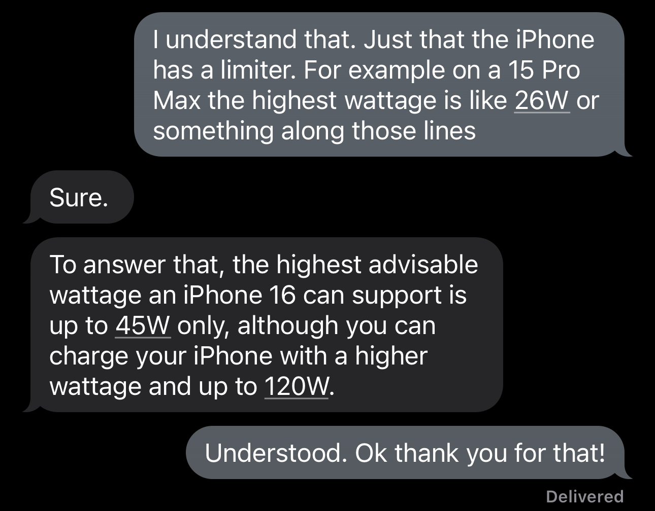

so essentially it only ramps over 30W in extreme use situations?
Reactions: ikjadoon
That's my understanding.
The "45W" is more of a limit, as I understand it. Previously, iPhones used the 9V x 3A USB-IF profile (which allows a maximum of 27W), where 3A is the maximum for normal USB-C cables.
USB-IF only has 5V*3A, 9V*3A, 15V*3A, and 20V*3A for most chargers (using the traditional fixed-voltage system). 12V is optional & thus rarely used.
5V*3A profile: 0 to 15W (3A) charging
9V*3A profile: >15W to 27W (3A) charging
15V*3A profile: >27W to 45W (3A) charging
20V*3A profile: >45W to 60W (3A) charging
So for Apple to even want 28W charging, Apple had to move to 15V and that profile allows up to 45W.
28W = 9V*3.1A = this violates USB-IF spec; you cannot exceed 3A
28W = 15V*1.9V = this is within USB-IF spec; it is below 3A
https://regulatoryinfo.apple.com/elabels/A3292 (can't find an active one for the 15 Pro, but I imagine it is 5V-9V⎓3A max).
