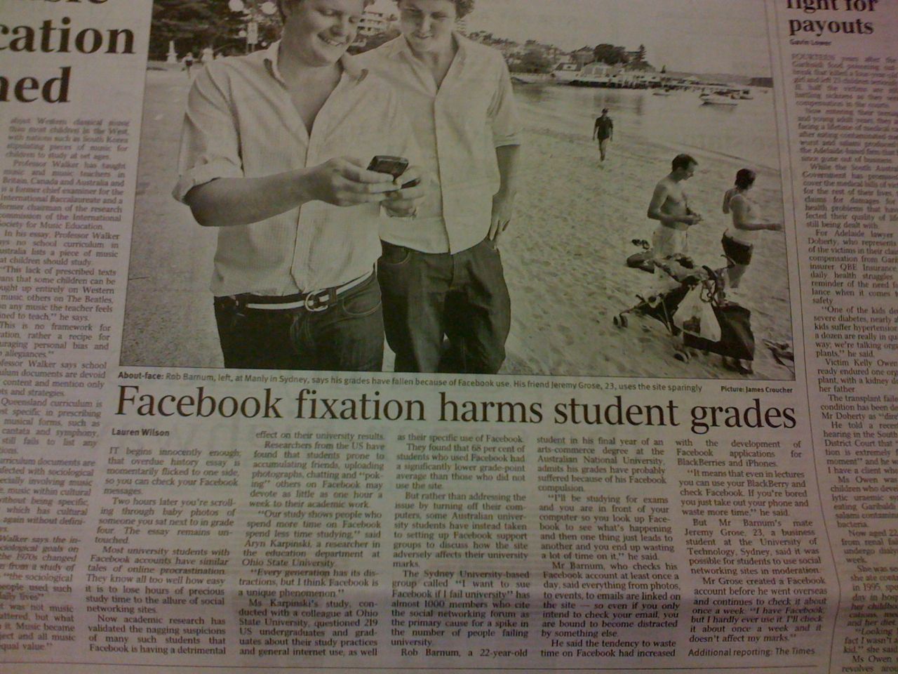

and i get a green tint towards the centre of all my photos. i guess it's the camera lens that's been exposed to bright light for quite a while... for example when i take a pic of a plain paper (in this case a really random news article... or is it?) -- look below.
P.S. if you really want to know, that newspaper is The Australian, 14 April 2009.
