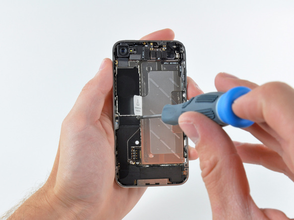

might it have something to do with static electricity, or just shorting the two parts of the outer frame (which is the antenna) by touching the bottom left side?
qAvU2dCNFxSRabmm.medium
