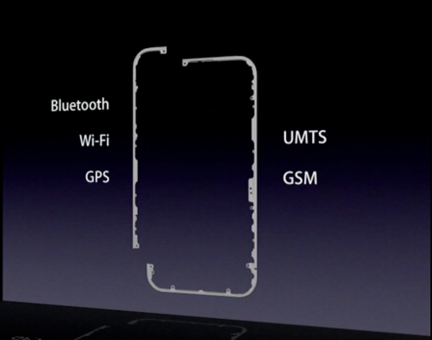

I didn't read all the comments in here but this is my theory:
As you can see, the left band serves as the antenna for Bluetooth, Wi-Fi and GPS while the right antenna is used for UMTS and GSM. When you touch the top or lower left gap you connect both bands and the signals are irritating each other until they eventually drop.
Most importantly: Everyone who is using neither Wi-Fi nor GPS nor Bluetooth doesn't have a signal coming from the left antenna, so there's nothing to irritate the right antenna when connecting both by touching.
It would be great if anyone could proof this by testing if this issue still appears when turning off the mentioned services and if people who couldn't reproduce yet try to turn on these services.
That's a great theory -- and makes some sense. This, combined with the fact that people are electrically different (skin conductivity etc) may explain the lack of consistent results.
http://www.abload.de/img/bildschirmfoto2010-06-a5ws.png
That's exactly what I'm thinking,
it would great if someone could test this - above mentioned - hypothesis above!

Anyway, I tried this guy's theory turning off gps wifi and bluetooth and still drops to 1 bar when held with left hand.
I managed to do this once. and it was only 1 bar that went down from full bars to 4 bars. I keep trying, but most of the time it seems fine, and only some times 1 bar goes down. I think thats typical with phones.
I tried with my 3GS and that's exactpywhat happened.

Use a Penny so we can get consistent results
Could everyone testing this please just use a penny to short the gap between the antennas (as airbai has done)? And short the left side, top and then both gaps.
This would reduce many inconsistent results from the different conductivity in peoples skin.
Thanks 🙂
Thanks 🙂
I tried with 5 cents, it even went down to the "Searching..."
