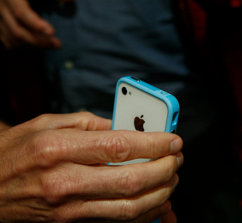

"Antenna Problems, Why fix it? Lets just make our own Bumper Case
When I was watching the iOS 4 Demo with the live feeds and the "Bumpers" case was unveiled, I started to think why would Apple come out with its own case? Well it's obvious now what they were trying to cover up, trying to hide the antenna from the users hand! Apple knew this was an issue from the start and new a case for the metal banding around the phone is all they needed.
If this is an issue which Apple decided to act as if it were not lets see if the case fixes it!
Brent V
Not sure if this has been said or not yet but I have just received my iphone 4 and a bumper. I'm having the problem even with the bumper on. The bumper makes very little difference to the problem.
I've got the same issue on o2 UK. A friend of mine also had the issue, and managed to get a bumper case which certainly does cure it for both of us. Must be more to it.
Cant do it
I just got my iPhone 4 32GB and i can not replicate this at all nor are there any yellow dots i got myself a perfect phone ^^:D
I don't buy the bumper as a cover up theory. It makes about as much sense that they just wanted to get in on the case business/show a new type of case and didn't want to cover the back.
And as far as the nickel test, I still had a bar of signal doing it where I am so I think this a combination of a lot of issues. Since Apple said they're going to release a software update to fix it I'm going to assume they will partially fix this issue (again, holding any phone can result in some signal loss so they can't completely get rid of this).
