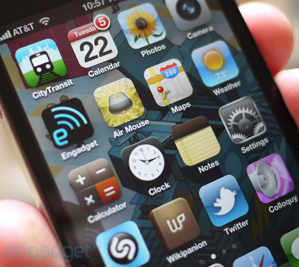

Ok
this is from the engadget website review
He is holding the iphone 4....
http://www.engadget.com/2010/06/22/iphone-4-review/
view these videos, he is holding and on facetime.
Think about it. If it's going from 4 bars to NO SERVICE, it means you can't make or receive calls. And what happens when you're in an area where you don't get 4 bars? It'll go to NO SERVICE even quicker.
