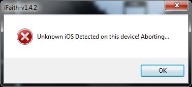

Yes, understood all pointers above, but is getting this error in iFaith
I've been trying to fix my iPhone 4 GSM and tried all possible methods where I started a thread at https://forums.macrumors.com/threads/1357474/
Thanks for your help!
