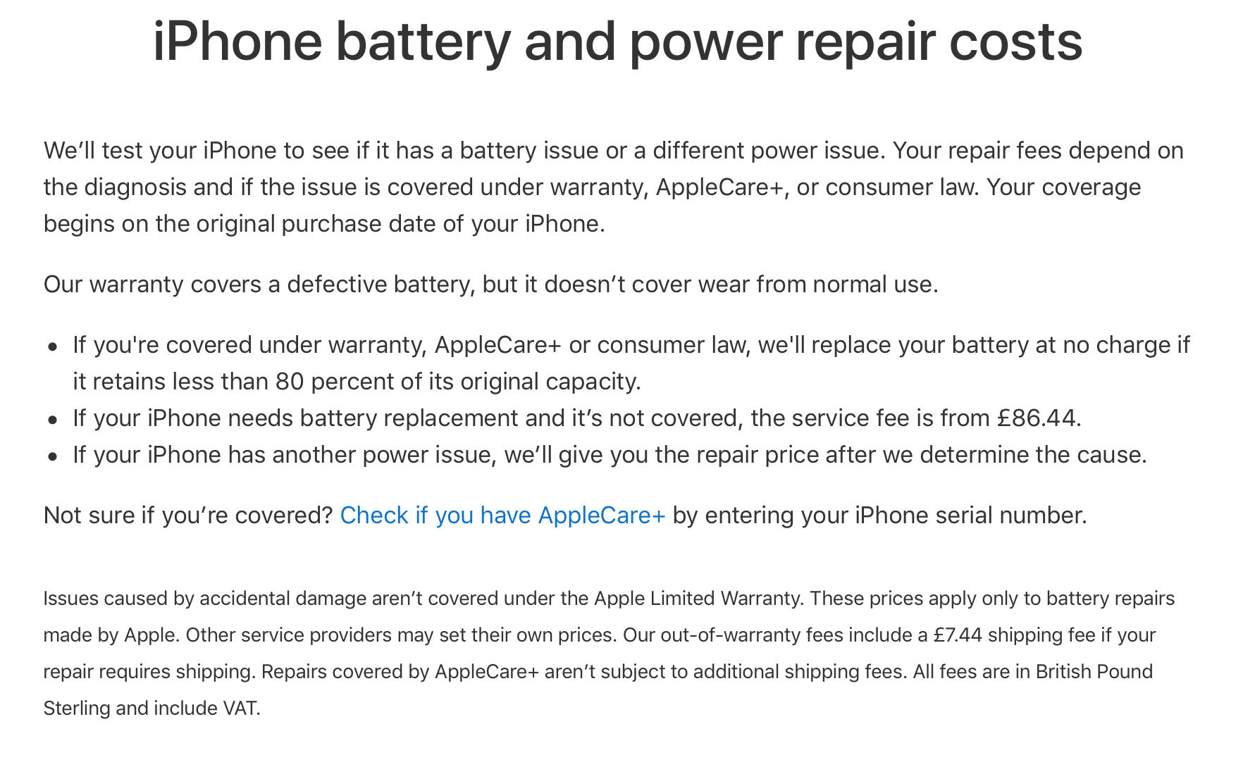

Found this on the Apple site.

They will charge you for the cost of the battery and no more.
It will be a replacement iPhone 5.
