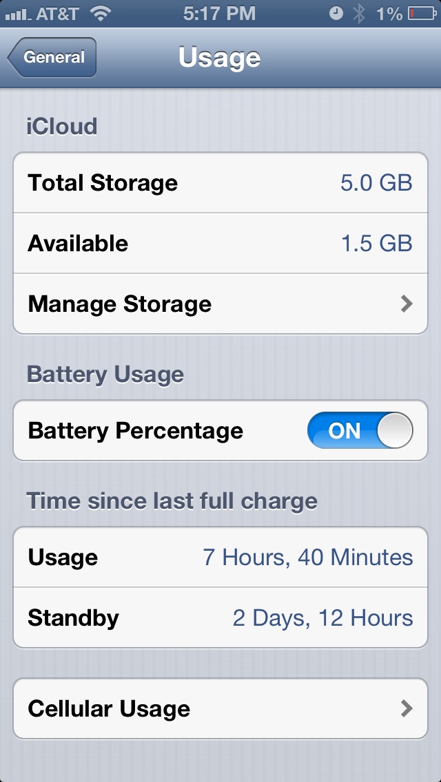

WTF! I'm def not getting life as most of you, I got my iPhone preordered first batch. It does lat the day usually, but can't use any Internet radio or anything to do so. Look at my numbers :-/ how does apple check for this?

Might have to set an appointment. Definitely not 11 hours of data usage

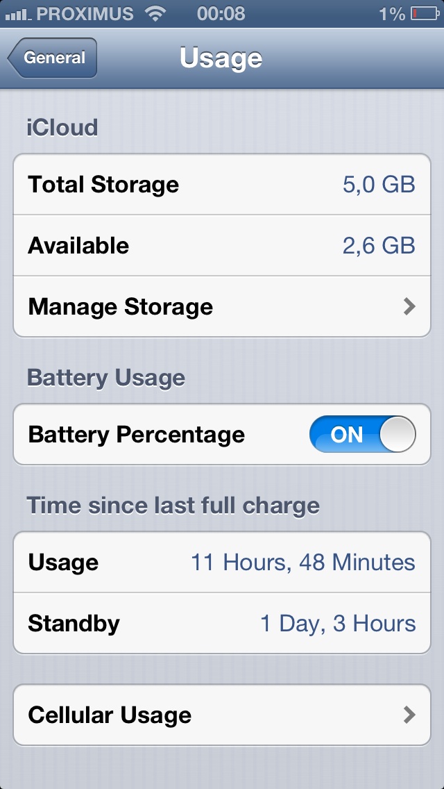

My battery life is great I think.
4g - ~16 hours
LTE - ~2 hours
Wifi rest of the time
Bluetooth on all the time
~1.5-2hours of talk time
~3-4 hours Bluetooth audio streaming

Ye 4G is a real drainer but it doesn't change the fact that you can post your battery usage here if you're using Wifi.
Try 3G , I think it drains less than 4G. I can't use 4G so I can't try that.
However - I still can't figure out why people are using 4G over WiFi when we're living in 2012. Wifi's are everywhere bros.
because if you haven't yet learned 4G/LTE is double and triple the speed of wifi....

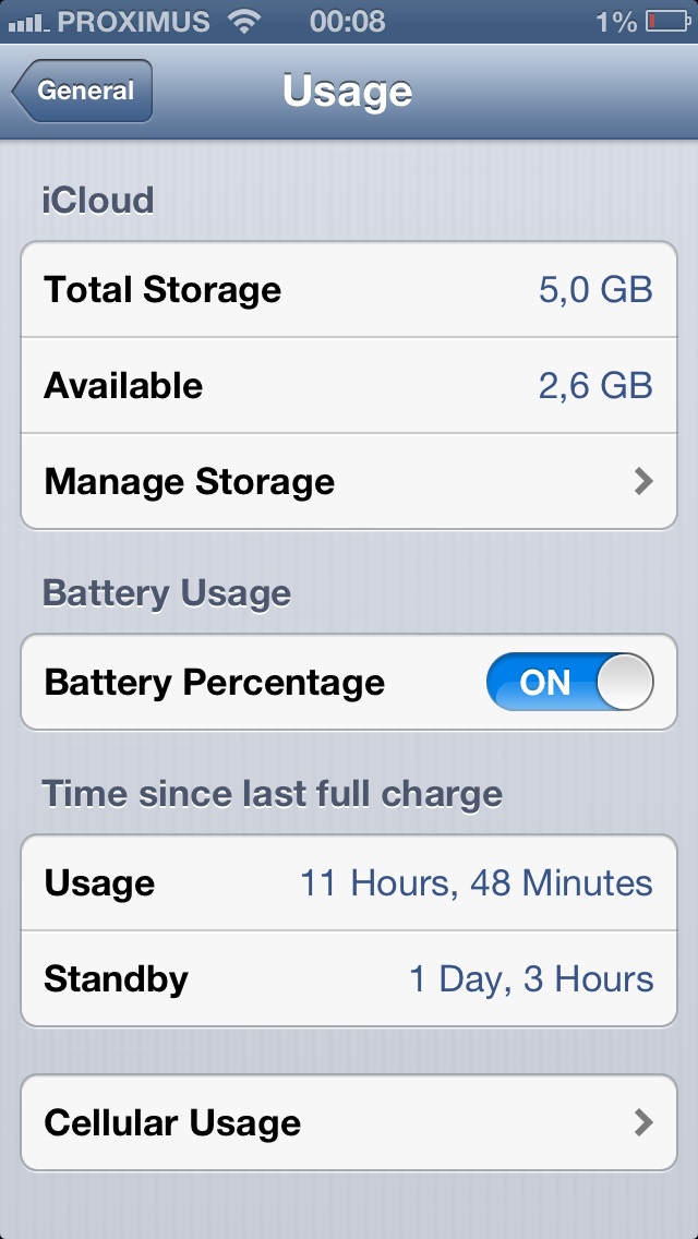

Pretty neat. Although its weird.. Sometimes it get more than an hour to go from 100% to 99 and sometimes 15 mins. With moderate use.
