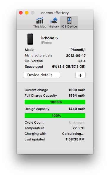

One brand-new dock connector and NOHON battery later, the iPhone 5 is perfect. But let's focus on the NOHON battery now, so I bought it because I saw no reviews on the battery/it seemed to have claims which weren't that unachievable(ahem Gold 4S batteries). It claimed my iPhone 5 would have 1590, a nice little boost from 1440 if true and some room for the battery to degrade while being at its full design capacity still.

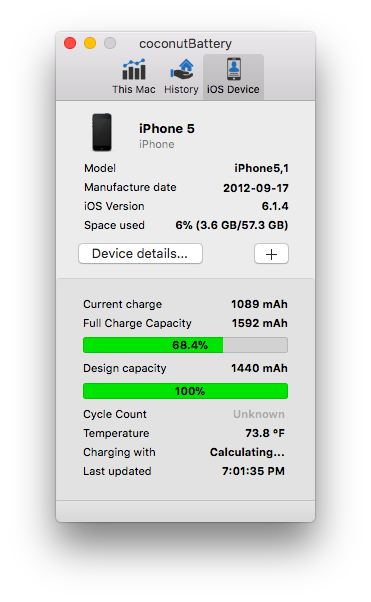

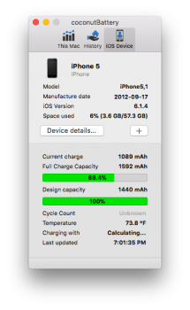

Fired up Coconut Battery and to my surprise, it is a real 1590mah battery.
I also use a Cydia tweak to display the iPhone's battery info in the Notification Center which also reported it being 1590mah.
Hope this helps out any users deciding on buying one of these, I'm very happy with the result. I'll try to update this thread on how the performance is a week from now, a few months later ,etc.
It's currently fully charging so when I reach 100% I'll post a full battery shot.

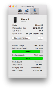

Here is 1440mah(what it's design capacity is):

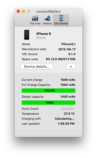

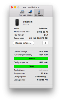

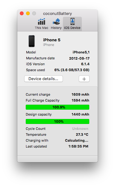

EDIT: 100% shot

Give it a week of usage before reporting. The full charge capacity value is set at the factory. Until it's been through a couple of cycles, the true value isn't known.
Alright will do, thanks for that piece of information!
