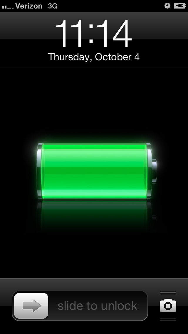

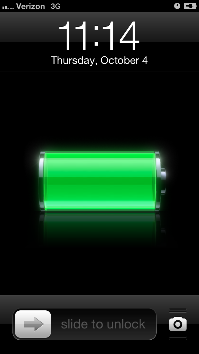

I am having the same issue. My phone is currently behind by 1 hour and 35 minutes. I first noticed it 2 days ago when my alarm went off unexpectedly. At that time I had set my clock to manual and later in the day I set it to automatic. I hadn't seen it happen again until this morning when I looked at my phone and noticed the time.
I have an iPhone 5 with Verizion in Indiana.
The only additional information that I can provide is that where I am currently located, I jump between LTE and 3G quite frequently. Attached is a screenshot I took a few minutes ago.

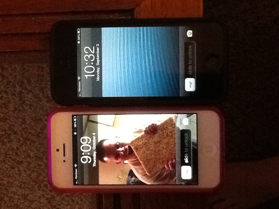

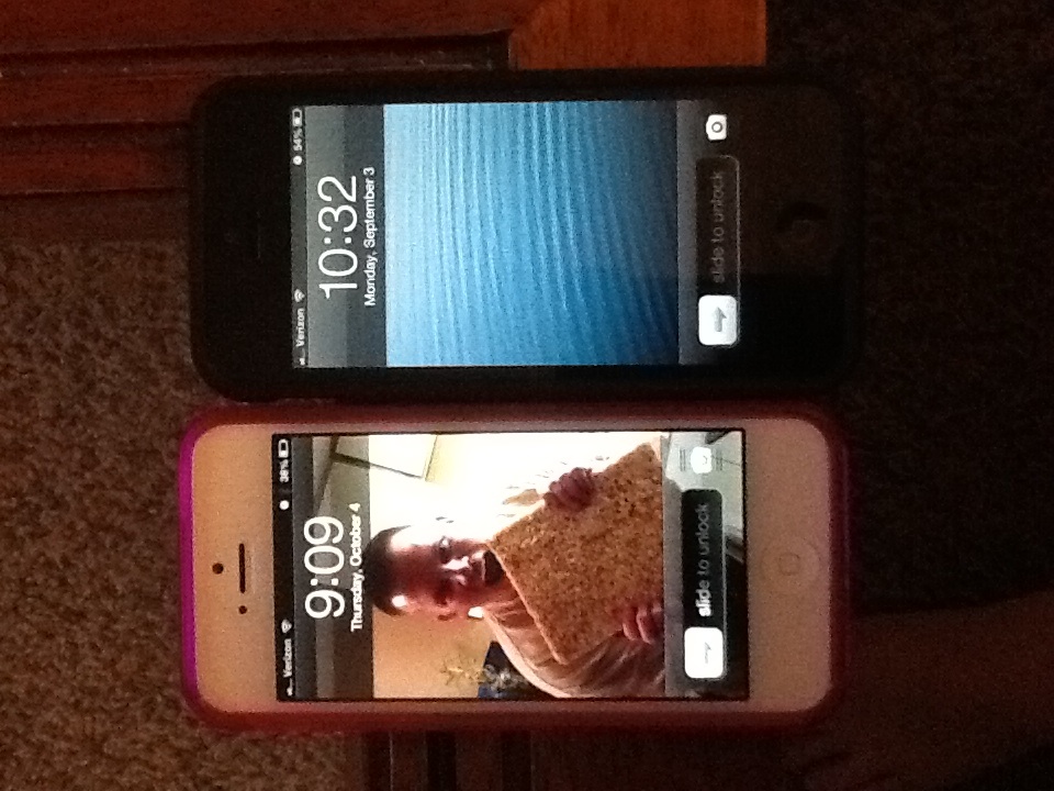

Well... After two trips to apple. Two wipes, one restored from backup and one set up as a new phone it has happened again. WTF!!
