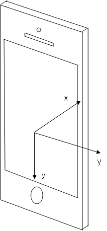

Because I'm interested in these things I've put in a bit of time to get my thoughts down on the problem from a purely academic point of view and thought some people may be interested to see what I have put down, for those that aren't feel free to skip over it.
To assess the orientation of the phone, the processor receives the triaxial data from the accelerometer, and resolves the acceleration data measured on each axis.

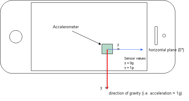

When the phone is perfectly horizontal as shown below (assuming the axis of the accelerometer are perfectly aligned to the phone) there should be no acceleration measured in the z axis, and a full 1g acceleration measured in the y axis.
Please note - where I have used the term sensor values related to measurements of g, obviously these values are processed based on raw electrical data output from the sensor, however for the sake of clarity of point I will continue referring to the sensor values in g.
[url=http://i128.photobucket.com/albums/p188/sport1901966/HorizontalAligned_zps07c2c75e.png]Image[/URL]
If the phone is rotated around the x-axis (into the page/screen) y gets smaller and z gets larger, until they are equal. At this point, when y = z, the angle of rotation is 45°, past that point z gets larger as y gets smaller until z = 1g and y = 0g, at this point the angle is 90°.
