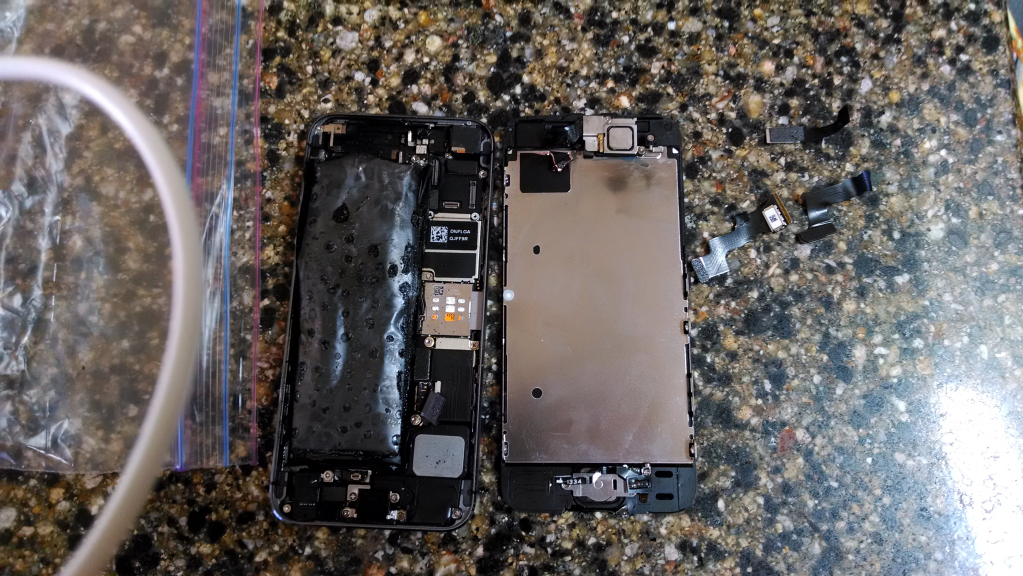

I suggest you have a read back at the outcome of the OP's visit to Apple, as they didn't agree with you and replaced the phone (*after* they inspected it).

The back of the screen had cables that were clearly ripped off, and it's warped in the shape of the expanding battery, the tabs are damaged and the screen is singed.
How exactly do you puncture a battery on a phone that is closed? Are you saying this guy can puncture things straight through matter? Because that's magic.
Your tone is clearly trying to violently verbally assault the OP, you even claimed that Apple's legal team would go after him. All the while you fail to understand all basic information here but went straight into a vicious attack predicated on an impossible scenario.
I don't think I verbally assaulted anyone. And I don't work for Apple or their legal team. I was stating that what I think he is doing is actionable if his story is proven false. The only "impossible scenario" is the one the OP has presented. Here are some observations that substantiate my theory, minus the *magic.*
The display was not "ripped off." The pentalobe screws on either side of the lightning port were removed with a pentalobe screwdriver, that the OP admitted to purchasing, even though he had "no reason" to open his phone. If they "snapped off" as the OP claimed, they would still be inside the phone. They were not, in the photographs.
After removing the display, the ribbon cables underneath are attached to the logic board. The connection points are protected under an EMI shield that is held in place by four screws. If the display were ripped off, it would indeed tear the ribbon cables off as the OP claimed after being questioned about it. However, those cables would not be laying freely as pictured in the follow up post. They would still be attached under the EMI shield. The shield and its four screws were removed with a screwdriver. It could not be removed by force without damaging the surrounding elements of the logic board. It is important to note that in the photographs, the EMI shield and cables are not present when the device is smoking.
Also shown in the photographs, the battery ribbon cable is disconnected. This cable is also located underneath a second EMI shield, held in place by two more screws. It cannot even be suggested that this shield was "ripped off" because the battery was not removed and the ribbon cable is undamaged. This piece was also intentionally removed.
For those unfamiliar with dismantling an iPhone 5/5S, the process would be to remove the two pentalobe screws as Ive described. Remove the display as Ive described. Remove the first EMI shields, then unplug the ribbon connectors, as Ive described. The next step is to remove the battery. That would involve removing the second EMI shield, unplugging the battery cable (again as Ive described above) and THEN PULLING THE BATTERY UP FROM THE ADHESIVE IN THE CASING. This step is very dangerous if done improperly. If one is not aware of the danger of lithium batteries, they may try to use the screwdriver they've been using up to this point to wedge underneath the battery and pry it upward. This can result in the sharp metal end puncturing the underside of the battery. Puncturing a lithium-ion battery will cause a chemical reaction that results in bulging and possibly fire.
It is my theory that "ripping off" the display and leaving the phone in its pictured condition is physically impossible. Taking the time to remove 10 screws, 2 EMI shields and disconnecting 4 ribbon cables during a battery fire is also highly improbable. It is also not the version of events being alleged by the OP. You can agree or disagree but I believe the phone was intentionally being taken apart for one reason or another, the battery was inadvertently punctured and a story was fabricated (including the damage done to the display and ribbon cables AFTER the incident) that would lead to the OP getting a replacement phone from Apple, which he received. You don't have to believe me, but that is what the pictures tell me. If anyone has any technical or factual information to dispute my claim, I'm all ears, but the fact remains that ripping the display off would've caused damage inconsistent with what we're seeing in the photographs. Either way, OP got a new phone and I doubt we'll ever know the findings of Apples internal investigation of the matter.

Didn't apple mention that some iphone 5s' had defective batteries installed which made them not last as long as they should have been? Perhaps OP had a defective battery that was more than just a capacity issue?
Or they just wanted it out of the way. The genius said no. The manager said yes and replaced it. The managers won't be technicians, so the "inspection" resulted in a no.
Ummm no. If you look at the picture of the screen next to the back provided by the OP the mounts for the screws used to hold the screen to the chassis are clearly broken on both sides and bent back outwards away from the center of the phone.
http://oi62.tinypic.com/2hdt9x4.jpg
(it's necessary to see the photo at full resolution to notice this)
2VGKpWTuiSVrUmSN.medium
There is no scenario where you can take apart the phone where the these mounts will bend outward, as you HAVE to unscrew them first for disassembly, and you HAVE to lock the top of the screen in before you put the pentalobe screws in.
The condition of his severed cables and the pentalobe mounts can only occur when the screen is being ripped from the phone at the top, which cannot happen without ridiculously improbable use of suction cups or the phone expanding from the top from the inside.
Read that a few times if you don't get it. It is impossible to replicate the damage to his pentalobe mounts without the top of the screen being forced off the phone, and the only way that can happen practically in this scenario is if the battery swells.

OP, stuff happens and out of millions of units some bad batteries make it through. They will replace your phone, above that nothing more should be expected.

I've seen posts before of such a thing, usually the glass breaks or something. If you google 'phone exploded battery' you'll find some pretty ugly pictures including a few iphones.
Surprisingly, the iphones usually break where the screen pops off on one side and the battery spews out that side lol. Some of the non-apple phones in there have some really nasty looking results where the battery busted a hole in the middle of the plastic.
