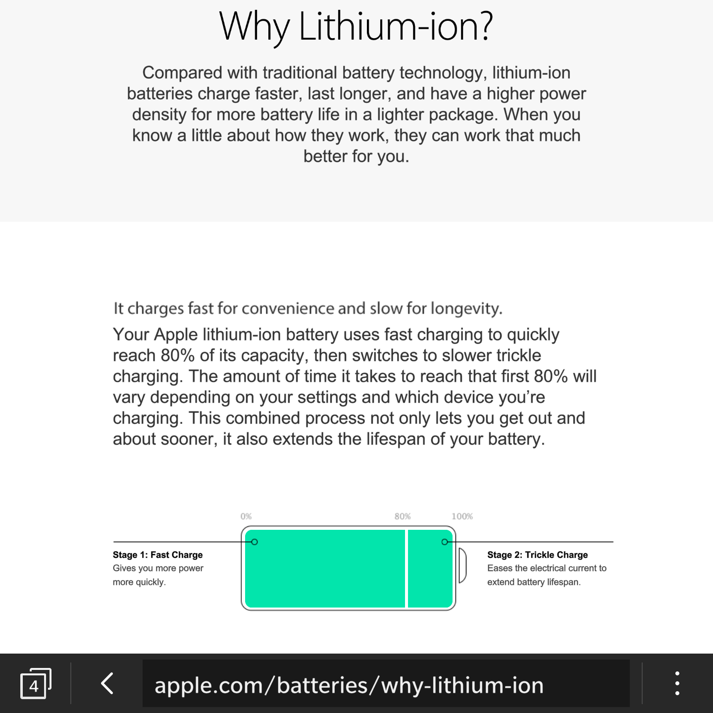

Found this on the apple website. Hope this settles the issue with fast and slow charging. Also it surely means fast charging is not "unhealthy".
Clueless People Talk Too Much!!
As was stated previously, the phone draws the current; current isn't pushed through the phone, destroying circuits in its path, like some have alluded to on this forum. LOL! Furthermore, phones and most electronic devices, these days, are built with protections in place. If the current being drawn (yes, I said, "drawn"; not "pushed) were too high, the phone would protect itself and divert the current or shut the charging off altogether. Sure, you could argue that the circuits get hotter while charging and drawing more current, but, again, the phone is built with protective circuits that monitor for excessive heat among other things. People that don't understand how electricity and circuits work should not be giving advice on these forums and pretending they know what they're talking about. All they do is confuse others and delude themselves!! :eek:
