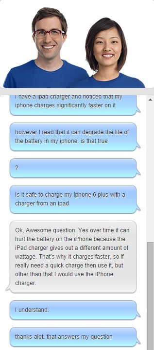

Well I just had a small chat with Apple. That is heir answer on the topic. I think from now on I will be using the regular charger.
