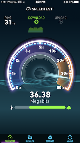

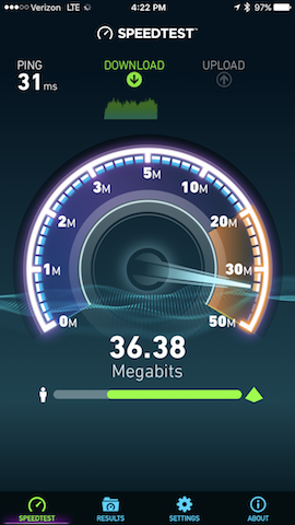

Verizon, iPhone 7+, 3 bars, Los Angeles.
