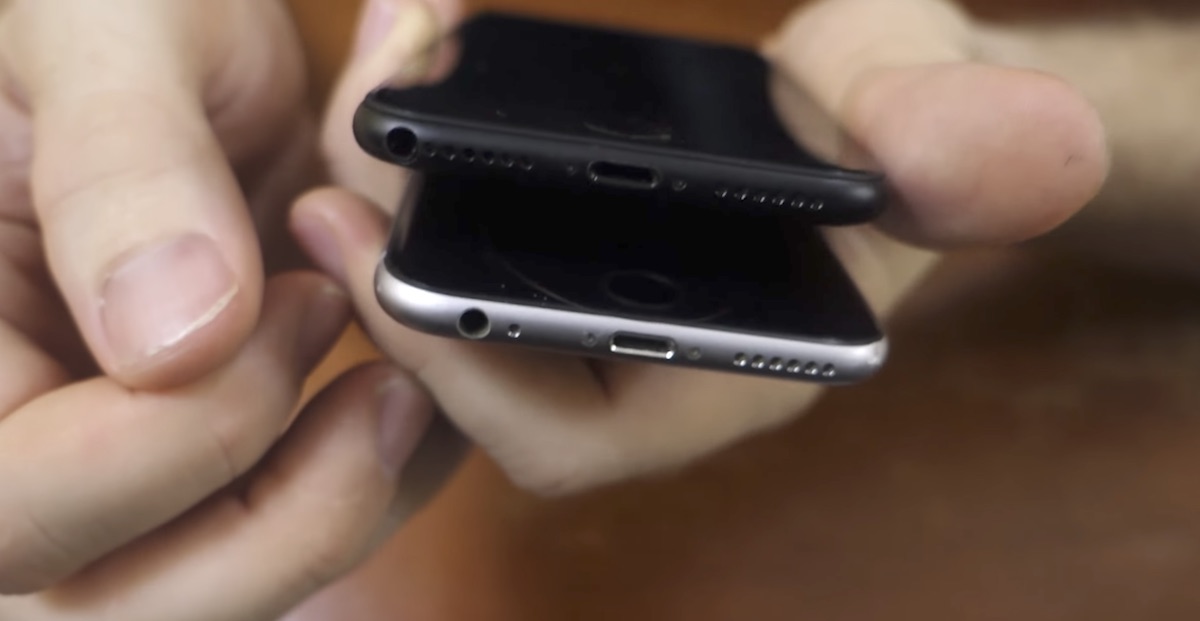

Former software engineer Scotty Allen has posted his second video to YouTube this week, in which he decides to modify an iPhone 7 in order to add a functional 3.5mm headphone jack into the smartphone. On the Strange Parts website, Allen explained that he spent four months on the project, working in Shenzhen, China assembling the tools, going through 7 custom circuit boards designs, and 3 disassembled iPhones to finally arrive with a working unit.
Allen said that the hardest part of creating an iPhone 7 with a headphone jack centered on the electrical design and fitting the new parts inside of the smartphone. Upon the release of the iPhone 7, Apple said that the removal of the 3.5mm headphone jack was needed to make room for the internals of the new camera system -- as well as increasing water resistance -- but Allen found that "there was inexplicably a lot of extra room" near the lower left hand corner of the iPhone 7, where he added the component.
The modded iPhone 7 (above) compared to an iPhone 6s (below)
While Allen's feat is notable due to many iPhone users' ongoing complaints about losing the headphone jack on the newer iPhones, it isn't a practical solution for everyday users. Allen pointed out that he went through designing numerous circuit boards that were "more complex" than anything he's ever done, as well as spending money on "lots, and lots, and lots" of spare parts and advanced disassembly tools.
I'm pretty proud of the final implementation. I took apart an Apple lightning to headphone adapter, put that inside the phone, and hooked it up by man in the middling the lightning jack with a flexible PCB. The PCB has a switching chip that switches between connecting the headphone adapter to the phone by default, and then disconnecting it and connecting the lightning jack when something is plugged into it. I have a couple other timer chips that briefly disconnect everything from the phone when something is connected/disconnected to improve the reliability of the phone detecting when something is plugged/unplugged (otherwise it sometimes gets confused).
The full 30-minute video goes into detail of Allen's project, and he reveals the successful final product at the 30:00 minute mark. One downside is that the modded iPhone 7 can't listen to music and charge simultaneously, which Allen admitted would require a "pretty serious engineering effort."
