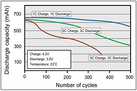

It's not "wrong," but, yes, faster charging does tend to wear out rechargeable batteries a bit faster than slower charging speeds. However, just because you're using a 12W charger doesn't mean the device will charge at 12W--it's not like a car battery where you're hooked up directly to the terminals. Here, the software will negotiate an acceptable rate that the device is willing to accept. (I actually think the iPhone will go up to 12W, but I could be wrong about that, though I think the supplied adapter is around 5W.) The difference might not be something you'd notice over the course of life of a typical iPhone--or it might be--but I just prefer to charge slower when I don't mind the time it takes.
Do you have proof it damages the battery? I want to see some because plenty of Android users do it with no issues at all. I think it's just a marketing excuse to help maximise profits if Apple goes down this road...
It's a fact that can be googled all over the internet. Heat, fast charging and deep discharging batteries effect their overall capacity.
http://batteryuniversity.com/learn/article/ultra_fast_chargers
*C refers to the normalized discharge/charge rate.
You also have to keep in mind a lot of the Android phones have larger batteries, meaning their normal charge rate is designed to be higher.

So that is why a lot of androids are able to support these higher rates because their batteries are designed to be larger and therefore can support higher charge/discharge rates without taking as much damage.

Usually a larger battery means you are capable of charging faster. And charging any faster than the recommended rates will result in faster degeneration of the battery. Which I am pretty sure was consistent in my post.
There are a LOT of things that effect battery degradation, including temperature and deep discharges being the most common. Manufacture quality also has a lot to do with it. There are also 'People' who's phone last 3 years without any battery problems, anecdotal stories are irrlevant
I am saying there is a reason why Apple does not advertise high speed charging. There is also a reason they limit their charging speeds. I can assure you that when you plug your phone into a 12W charger it is not using the full 12W but is likely closer to 8-10 at MOST.
I think what Battery University is saying, if you can charge slower, it can help the longevity of the battery. If you charge faster than the battery is designed to charge, abnormal wear on the cycles will result. Batteries designed for rapid charging are not seeing that much degradation. Li-Ion batteries today are far more robust than batteries even 5 years ago.

I am not arguing with you. I am stating facts.
Batteries are both a simple and complicated thing and their chemistries change from manufacture to manufacture and no 2 batteries will ever behave the same.
But I can without doubt tell you for a fact that any sort of fast charging WILL damage the battery. Now some manufactures might find ways to reduce the effect to an extent but it is still happening. The difference might be 1% over a year due to fast charging or it might be 10% a year due to fast charging. We will never know unless someone takes the time to actually do the test on specifically the iPhone batteries.
