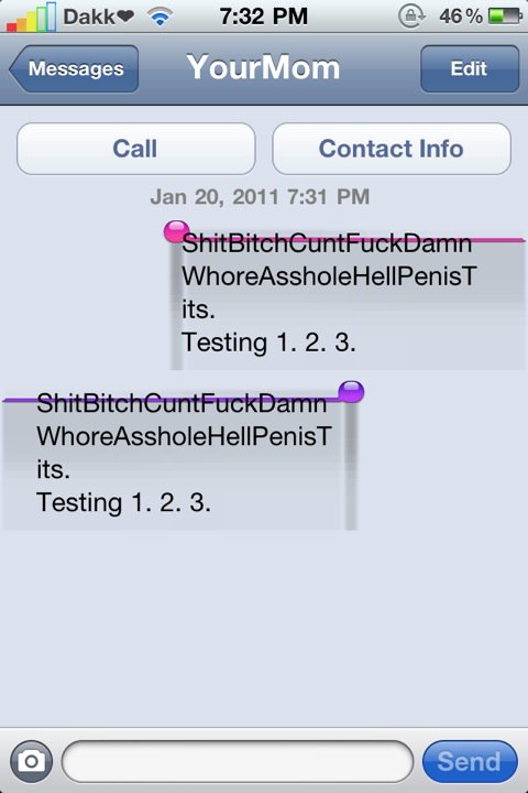

Anyways, since I am learning the whole SSH deal, I've tried to change the SMS bubble colors through Cydia. And, I found the exact colors, I've gone to iFile, changed the name to the Balloons_1@2x~iphone.png and everything, then restarted it.
I no longer see the green and gray, but instead of being a full bubble, it's a line that crosses out the first sentence, with a tiny bubble attached to the end.
How do I fix this? /:

I don't get the whole SSH thing, and I've had my phone jailbroken for a few months but am still new to all of this. My knowledge extends to Cydia, and Winterboard. And sometimes iFile.
There are four files in all
u get this problem if u overwrite the "Balloon_1~iphone.png" and "Balloon_2~iphone.png".
To fix this problem copy back the original "Balloon_1~iphone.png" and "Balloon_2~iphone.png" files
