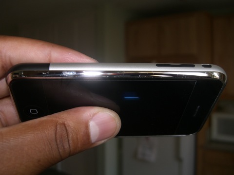

I was one of the unlucky people that purchase the 'Incase' for my iPhone & the metal trim got all scratched due to lint etc. Since I was tired of looking @ the scratches I decided to give my iPhone a brushed metal look instead of leaving it with the scratched chrome. Check out my before & after pics ad let me know what you think. I did one side first then took pics. I'm actually working on the apple symbol on that back right now.

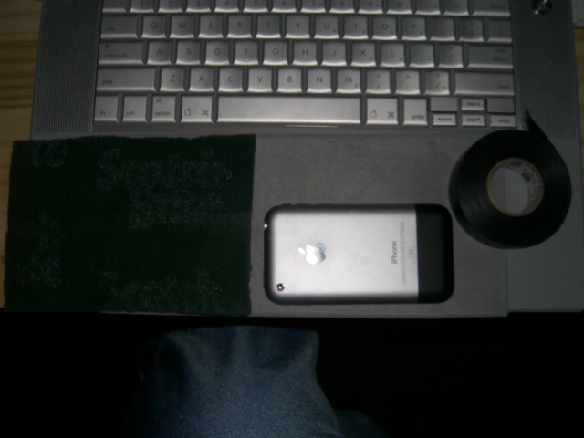

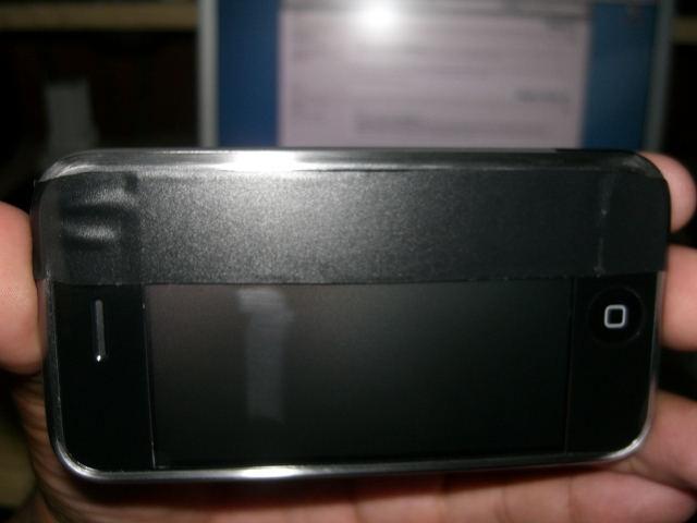

OK, I'm not very good and creating How-To's but I'm gonna try anyway. I've already finished the job but I did the process over to show you how I started and how I taped over the screen and back to do this.
Supplies: Electric Tape, Scotch Brite Sponge & (of course) an iPhone
1st: you want to use the electric tape and cover the edge of the screen as close as possible the chrome trim. Repeat for the back also..
2nd: use the Scotch Brite sponge and lightly rub one way & reverse.. Ex. Whichever side you start on first (I did one side @ a time) you want the sponge to meet the two corners. Keep going back n' forth till you get the look you want..
3rd: Because of the tape the corners we're probly covered like mine and you still have a chrome finish on them. This is were you have to be very careful and take your time. Cause you will have to do this freehand unless you have a way to cover the edge of your screen to brush the rest of the chrome. Once you've accomplished that your done.
The pics attached I have tape on the longside of the phone. You would repeat that same tape scheme on the top and bottom of the phone.
This isn't the best of tutorials cause I suck @ these types of things. Feel free to ask me any questions that you may have if you want to try this. Goodluck!

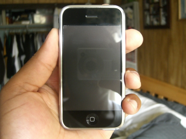

Can we see any pics of the phone dead on to see what it looks like from the front? I'm very tempted to do this but I'm posiitive I'll screw it up... also, using the electrical tape on the screen and back of the phone did not leave any sticky residue? I'm just so scared to damage the screen but my chrome also has a lot of scratches on it and personally I think the chrome was an awful design decision...

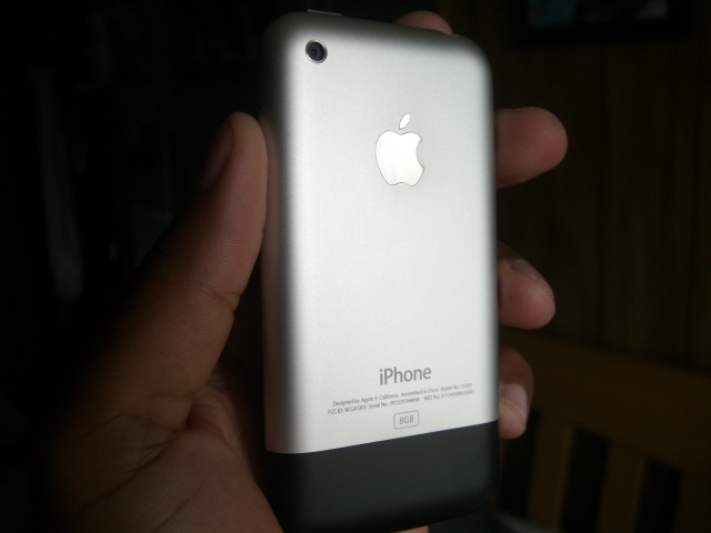

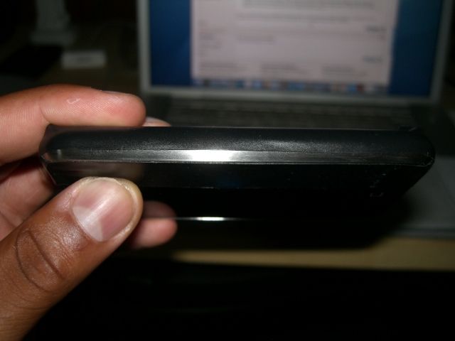

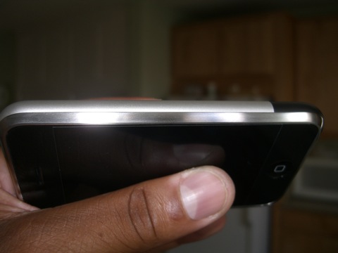

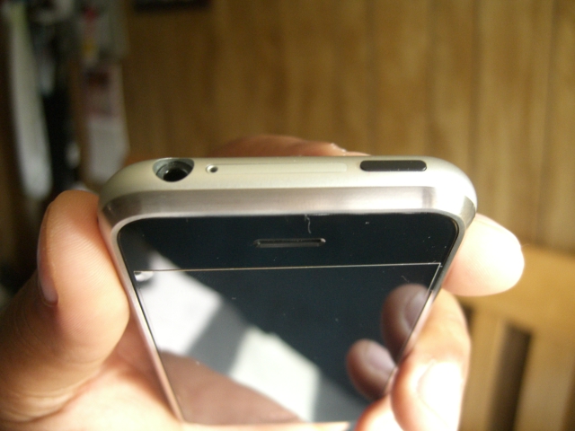

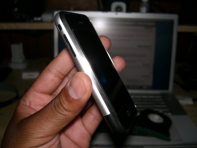

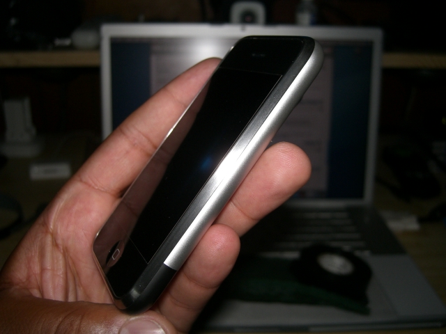

Here are pictures of the front, back, top and bottom close-up so you can get a better look. I also have a screen protector on their that is actually coming off. (Thats what the bubble is on the top left of the screen) The electric tape didn't leave any residue what so ever, but it did take off my screen protector when I was taking it off. No worries though i'll just go buy another one. I'm sure you'll be OK, just take your time and don't rush yourself.
