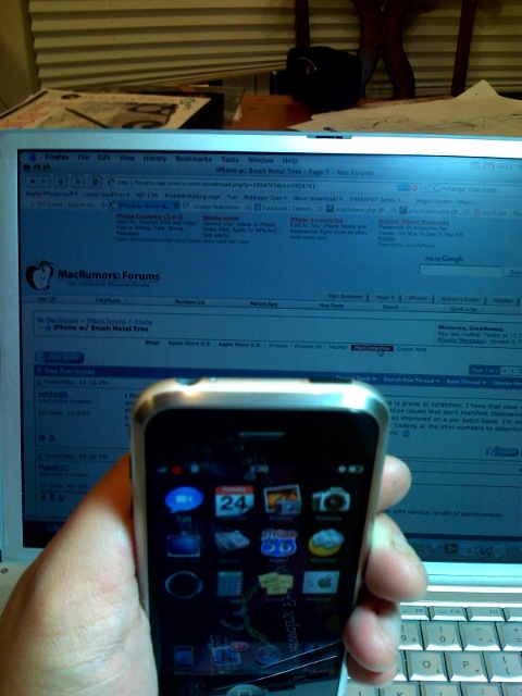

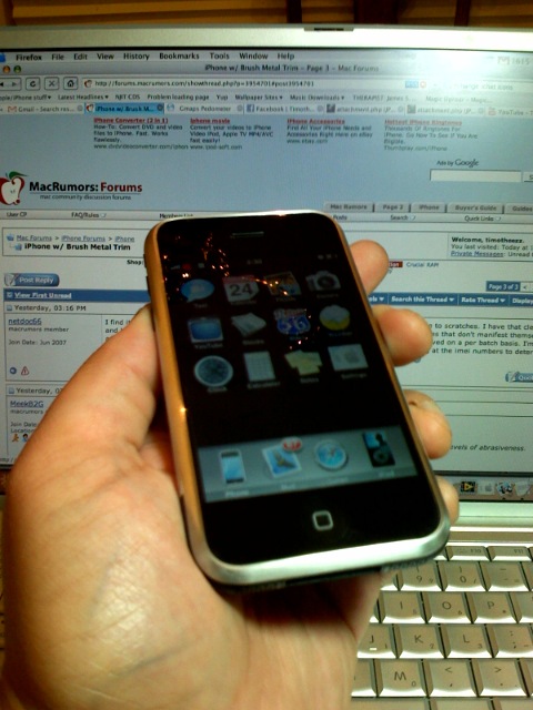

Finally done baby! My friend and I did it at the same time.
Unfortunately, we have no digicam available where we are (I know I know).
So I took a pic of my iPhone using his iPhone.
Yes, I hacked my iPhone and put custom icons (as well as custom ringtones, custom battery, and replaced the AT&T with a red Apple logo) hanks to guys at ModMyiPhone.com.
It took us about 2 hours because we were very very tedious in our "controlled scratching" of bezel. But the end results are amazing. These pics don't the phones any justice.
I love it!

I wonder...since you initially did this to get rid of the microscratches from using the Incase covers that everyone is complaining about, are you getting more of the same after this "controlled scratching" or is it not noticeable anymore because of the brushed metal look?
The brushed look will be no less susceptible to scratching than the original polished finish; however, scratches will be less noticable than before. Remember, the brushed finish you create is itself, a series of parallel scratches. How noticable the new scratches appear on the brushed finish depends both on the depth and angle of the scratch, compared to those in the brushed finish.
If the trim piece is made of the same material throughout (as opposed to a coated finish), you will be able to use your scrubbing pad to periodically buff minor scratches out with the same meticulous care that you practiced in the beginning.
