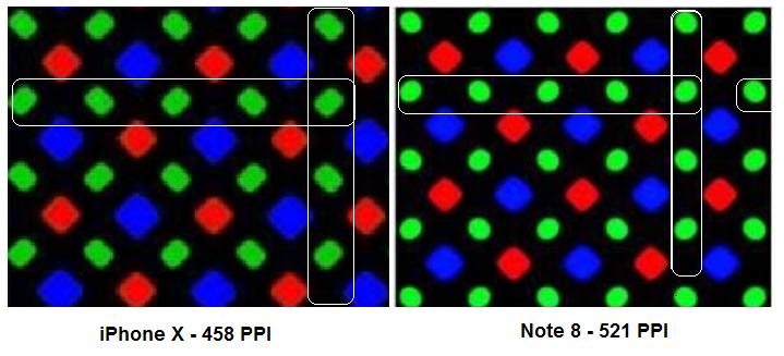

This is the photo of iPhone X vs Note 8.
The problem is, those photos are not of the same scale. That's why most of the resulting comments are the internet are bogus.
The Note 8 has higher resolution than the X. Adjusted correctly, the images would be more like this, with 1.2 times more subpixels per inch on the Note 8.
DisplayMate didn’t even mention the fill factor of the Note 8 or S8, while praising it in the X.
DisplayMate was simply once again praising Samsung's Diamond arrangement, not anything unique about it in the X. Waaaaay back when they tested the Galaxy 4, DisplayMate wrote:
"Then, in order to maximize the sub-pixel packing and achieve the highest possible PPI, that leads to diamond..."
They credit the higher fill factor for the higher full screen of X, which is in fact higher than Note 8/S8.
DisplayMate made no such comparison between those devices.

The problem with your argument is, those photos are not of the same scale.
The Note 8 has higher resolution than the X. Adjusted correctly, the images would be more like this, with 1.2 more subpixels per inch on the Note 8.
DisplayMate was once again praising Samsung's Diamond arrangement, not anything unique about it in the X. Waaaaay back when they tested the Galaxy 4, DisplayMate wrote:
DisplayMate made no such comparison, as they know that it is not higher than the Note 8/S8.
Display resolution isn’t relevant to fill factor, which is the percentage of the display that’s light emitting.
It's relevant when it comes to subpixels per square inch.
“On the iPhone X the resulting Sub-Pixel fill factor is much higher than other OLEDs, which is a key factor in providing the much higher full Screen Peak Luminance of over 625 nits.”
Yes, and again: DisplayMate was not comparing to other Diamond displays, but to "other OLEDs". They're simply saying that the Diamond formation gives a higher fill factor. The brightness was up to Apple's calibration and power consumption budget.

No one was talking about subpixels per square inch. We were talking about fill factor. More pixel coverage, less black space equals higher fill factor.
DisplayMate said “other OLEDs”. You’re choosing to read that as “other OLEDs except for the ones in Samsung’s Note8/S8.” But that’s not what they actually said. Your choosing to interpret it that way.
They said "other OLEDs" in reference to OLEDs that don't use the Diamond subpixel pattern.
You chose to interpret that as referring to other Samsung phones, which they did not do. You're the only one ADDING claims that did not exist.
