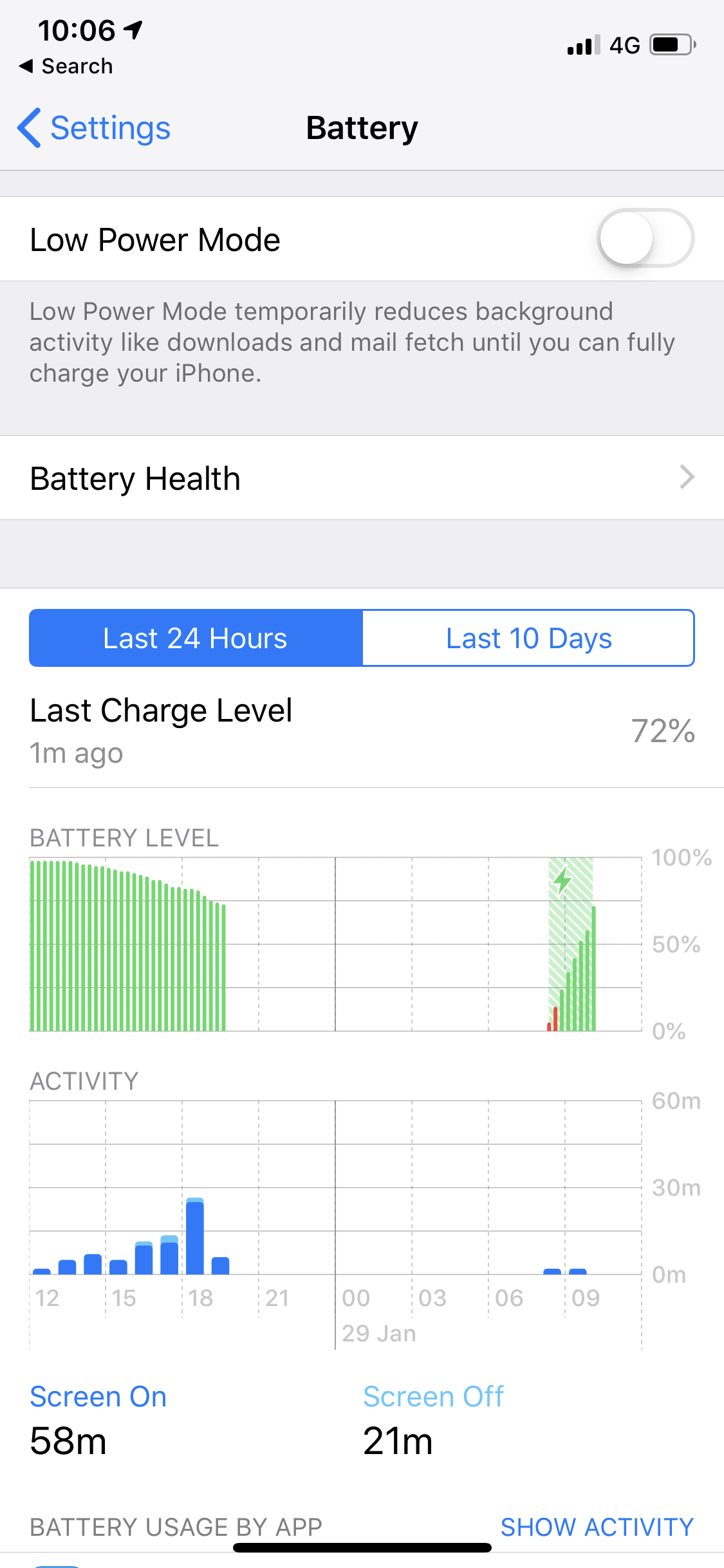

So, third iPhone XS and it happened last night. Totally dead and unresponsive, wouldn’t do a thing regardless of whether it was plugged in or what button combo.
But this time, a couple of hours ago I plugged it in again and it started charging from zero. Looking at the battery usage, it just drops off from 50% charge to 0 at the time it died last night.
I only ever use official apple cables and chargers, so I am stumped as to what is causing this - let alone for three handsets in succession. I have zero confidence in the phone so may go back to apple again and see what they are willing to do.

Another Genius Bar appointment made for tomorrow. I think over the three phones that's six trips in to the Store as I was turned away twice with "no fault found". I'll take in my charger and cables too this time as that's the only thing I can think of which may be faulty.

What I would say to anybody else with a similar issue is to take a screenshot of their battery usage as they literally can't argue with that and it backs up your case because again, my phone passed all diagnostics tests with flying colours.
